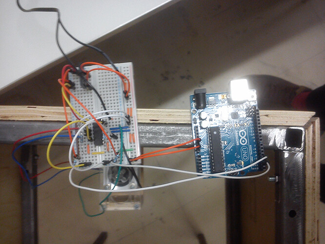

Hi so I am wiring my stepper with the schematic provided by arduino to control a bipolar stepper via two control pins, I cannot get the stepper to move and my L293D is getting very hot, I am using an AC convertor to 12vDC.
Can anyone spot a fault in my wiring or the code?
Cheers

The L293D can only drive very small stepper motors. I suspect that your motor needs a driver than can supply more current. Please provide details of the motor.

What motor?
What power supply? "12vDC" is not enough information.
What H-bridge?
What schematic?
These are the first pieces of information to provide!
