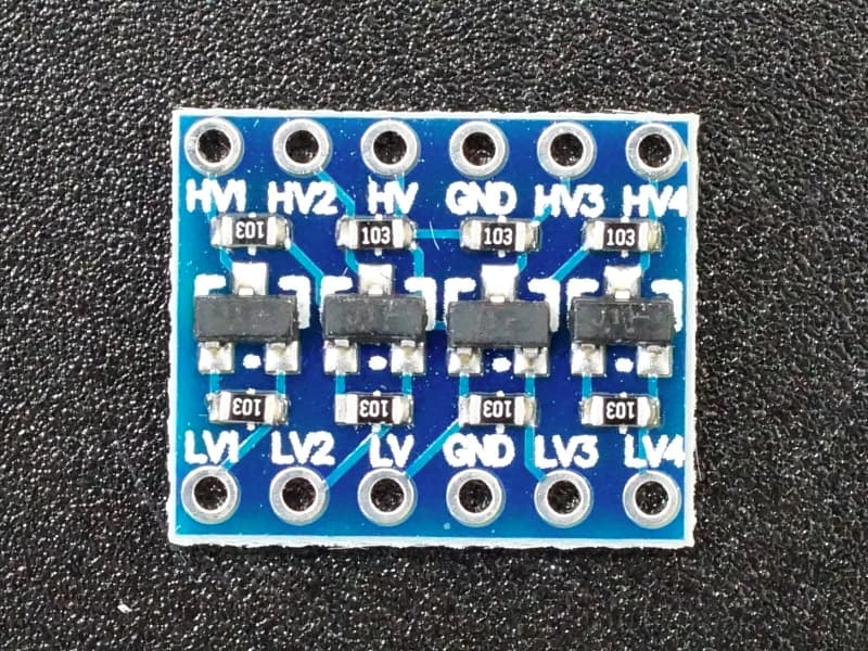

Hi, I am trying to control a BLDC motor (A2122 930KV) connected to a Simonk 30A ESC using an ESP32. I understand that this motor requires a 5V PWM signal, which is why I use a level shifter to convert the ESP32’s 3.3V GPIO (pin 4) to 5V PWM. However, the motor does not seem to respond. Previously, I tested the motor with an Arduino UNO, and it worked perfectly.

Level Shifter: Bi-Directional Logic Level Converter (4 Channel) 3.3V/5V

Using a level shifter like this?
Yes
That could be a problem. Those shifers are basically designed for use with open drain signals like I2C. They may not be able to drive the signal input on the ESC
You might try one of these ICs
SN74ACT244N
SN74ACT241N

Before you buy the ICs I recommended, you might first try powering the level shifter and the ESP from only one of the ESC 5V outputs and don't use the 5V output on the other ESC.
Thanks, I forgot I need to ARM the BLDC motor before using it. After arming the BLDC motor, it works fine.
That's why pullup resistors are required for proper operation of the level shifter - of course.
The open drain applies to the output drivers, not to the signals.
