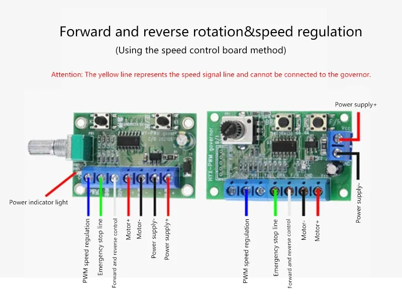

The motor has Red wire connected to battery positive, Black connected to battery negative, White wire I connected to power ground for direction, Yellow is encoder output, Blue wire for PWM input which I connected to Arduino PWM output pin.
My expectation was, motor will not run with pwm 0 and will increase or decrease speed based on pwm setting, but it keeps on running even when pwm value from arduino is 0. Other thing I noticed is if I don't connect pwm wire to arduino and only red and black power lines of motor connected to battery, it doesn't run.

Hi Paul, finally I found the issue. It actually operates with inverted pwm, meaning 0% duty cycle runs at full speed and 100% duty cycle stops the motor. That's why it was confusing. I was trying from 0, 5, 10, 20 pwm values in analog_write function which was running almost same, because motor has high rpm and those all pwm values were running at close to max speed so I thought pwm is not working but while experimenting different things, I noticed it actually gradually reduces speed as I keep on increasing pwm value and it stops at 255. Thanks for your help for all different possibilities you pointed out which will help for any future debug.
