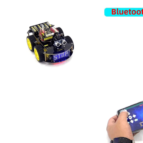

Hello! thanks for taking the time to respond and help.
Here is the link to the robot I have:
The code I put is one of the pre-shipped example projects for Bluetooth.
