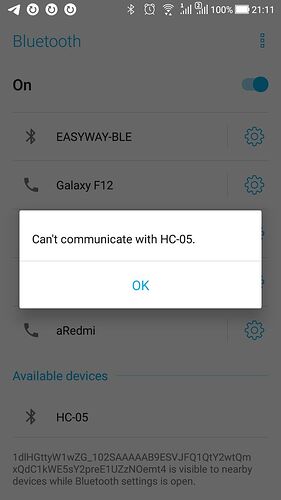

hi all i am using hc-05 Bluetooth module but i can pair with it i but 0000 and 1234
but still not working

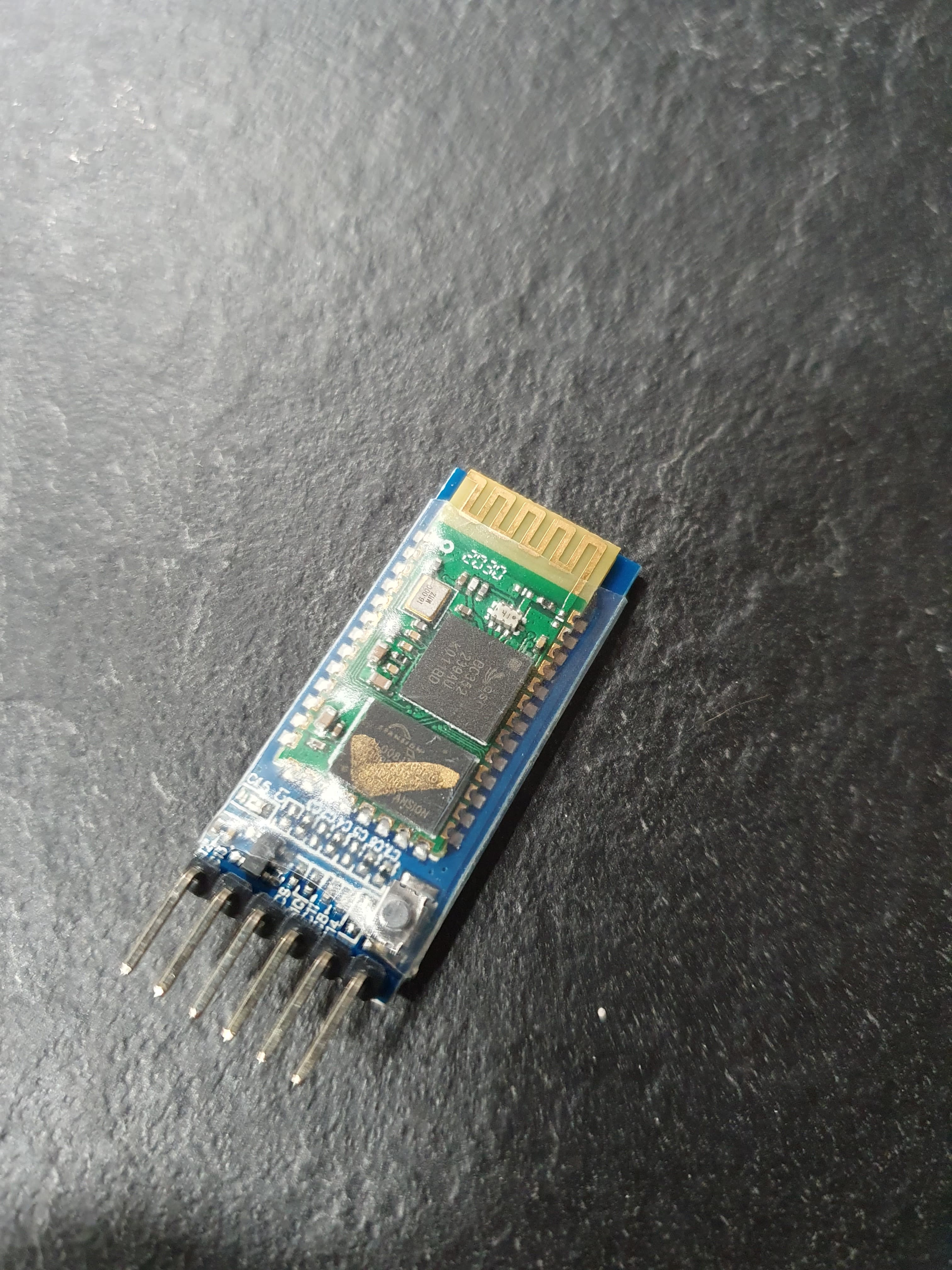

this is the module

thank you but i didn't made any code yet i just want to pair with the Bluetooth module
that what it gaves me in to password 0000 &1234
Then I unfortunately also do not know.... But there is a tutorial inside how to reset it. Maybe that helps?
OK, no code needed, you just need power and see the LED flashing. Clearly, the phone can see HC-05, so I assume it is an Android, and one of those passwords should work even if it is really an HC-06. How is Bluetooth powered?
I conect vcc to 5 volt and gnd to gnd and EN TO PIN 9 ,I give 5 volt in pin 9 ,and use pin 10 ,11 as rxd and dxd

MY PHONE or any another phone gives me it cant be paired so this is the problem

I have never heard of an HC-05 with two LEDs or a blue one. I rather suspect it is not an HC-05. Please show pictures and links.
I recall the pic in post#1, which looks asbolutely normal!
To pair and connect, to establish 'viability', all you need is +5V and GND connected (nothing else, and leave 'EN' alone).

Here is what I'm using
Yes, looks like an HC-05 alright. You might like to explain in detail the rest of your adventure. I realise that, while the author shows a Mega in the article, he may have actually been referring to a Uno etc when talking about software serial.
