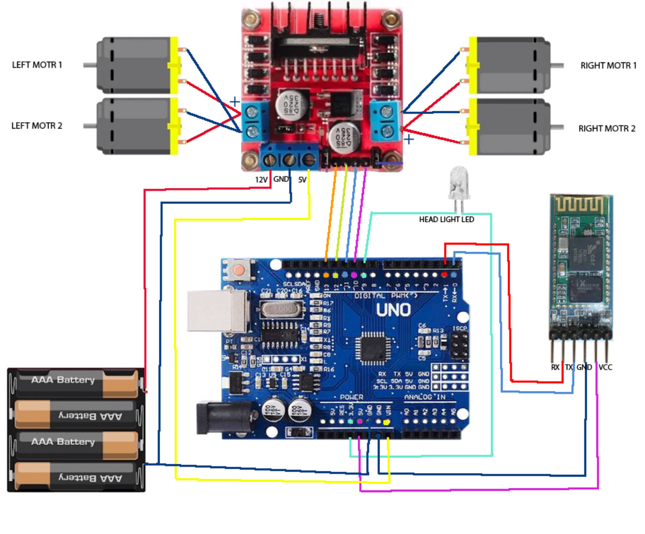

Hello guys, i made an arduino Bluetooth controlled car, and the Bluetooth module connects to my HP laptop only while the arduino is connected with cable to my laptop. When I disconnect the cable and turn ON the batteries my laptop sees the Bluetooth model but as soon as I press connect button my Bluetooth module shuts OFF.
Verify your power supply is strong enough. The motor driver and the motors use a lot of power and probably draw the power supply to a low level that makes the system stop or restart.
I made a Bluetooth controlled car, and I am using serial monitor on my HP laptop, to control it. The problem is I am able to control the car while the arduino is connected manually with my laptop. When I disconnect arduino and try to connect it with Bluetooth it works, my laptop sees it, but I am not being able to control it, it seems like it doesn’t revive the command I type in Serial Monitor.
So when I am typing F while having cable attached they do activate. When I do this without a cable my laptop does see the Bluetooth module, but the motors do not start.
I am using HC-05

You are putting 5vdc from the motor driver into Arduino Vin, which wants 7.5vdc.
Once you have the wire in the correct socket... your power supply is not strong enough. The four batteries you show equate to 6vdc. The motor driver will take all the power it wants, first, leaving 4.5vdc for the motors, bluetooth and Arduino. The motors will take the next bit of power remaining, dropping the voltage more, shutting down the Arduino. Use a suitable power supply that has 5vdc remaining for the Arduino AFTER the motor driver and motors have taken their amount.
