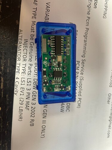

I am having trouble connecting my generic ELM327 to my ESP32. I can connect to my laptop and send AT commands to the ELM device. However I do need to input a PIN "1234" to connect the laptop to the ELM. I have not been able to connect the ELM327 to my ESP32 at all. I have tried all the baud rates with the ESP32_test example with no success. I have also tried changing the "OBDII" to my ELM's mac address, I was able to attain my MAC address and device name with the BluetoothSerial.h example DiscoverConnect. I know the ESP32 is seeing the Bluetooth device but something is interfering with the paring process.

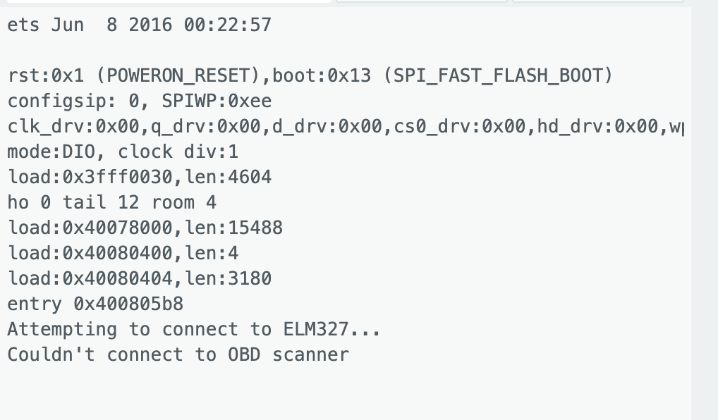

still no connection to my device with this update. I have tried all the baud rates and clearing the paired Bluetooth devices from my esp32. I have opened up the case and am not opposed to hardwiring into the RX and TX but I cannot find a data sheet for the IC it is stamped AB23PB1U243-69A2.
Have you got a clean compile yet?
Yes, I am able to upload my sketches to my esp32. I have included my code in my reply to [UKHeliBob]

I have opened up the case and am not opposed to hardwiring into the RX and TX but I cannot find a data sheet for the IC it is stamped AB23PB1U243-69A2. As far as getting you more information on my ELM327 chipset I have only gotten as far as connecting to it with a laptop and sending the "AT I" command I get the return ELM327 v1.5, I have found https://www.sparkfun.com/datasheets/Widgets/ELM327_AT_Commands.pdf datasheet with the commands

If you do not show the entire output, we are left to guess where it may have failed.
