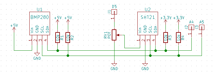

The 'trick' wiring is as follows.
----> The BMP280 pins are connected to the Uno as follows: VIN: 3.3V, GND: GND, SCL: A5, SDA: A4
10k ohm resistor between SCL and 3.3V, and another one between SDA and 3.3V
---> The SHT21 pins are connected to the Uno as follows: GND: GND, SCL: A5, SDA: A$
the trick is that pin D5 of the Uno is connected to a 10k trim pot meter. The wiper of this pot meter is connected to VIN of the SHT21. The pot meter has been trimmed so that the wiper delivers 3.3V.
As pin D5 can be set HIGH or LOW in software the SHT21 can be deprived from power, say 'switched off' while the BMP280 is read.
Do I do anything wrong with voltages? Hopefully not. I don't smell frying sensors (yet).

Then your schematic: not much that's right about it. I think it's this:
The SCL/SCA pins are connected to both 3.3V and 5V with fixed resistors, that's effectively a pull-up to 4.15V.
The pot RV1 is not a regulator. You can't draw any voltage from it without affecting the output voltage, which will drop rapidly.
I'm surprised this works at all - especially that the SHT21 works this way, unless the capacitors on board are more than filtering and can provide the power needed for long enough for the sensor to do its job. It may also be drawing some power from the I2C bus, which would be wrong, too.
Hi wvmarle,
Your wiring scheme is what I had put together, except that the BMP280 is powerd by 3.3V and that in my wiring all (4) pull ups are against 3.3V.
Per your comment on my pictures I tested both sensors with 5V at VIN. That works without problems, no sparks or pungent smoke. As a rank amateur in breakout board realms I lack te experience to determine whether a breakout has a voltage regulator on board, so I take precautions to protect my precious sensors against voltage dangers.
I took away the pot meter and connected the VIN pin of the BMP280 to 5V and VIN of the SHT21/SI7021 to D5, powering this sensor on and off when necessary. The BMP280 continuously receives 5V. Now I get two temperature measurements, one relative humidity and one pressure value. The BMP280 temperature differs 0.5 degrees centigrade from that reported by the SI7021.

photoncatcher:
Mind I never said with certainty it has, just that it looks like it has, mostly based on the part count.
Better ways to determine this is to know whether the breakout is rated for 5V, and when in doubt to check the numbers written on the components to figure out what they really are (or even to draw the schematics if you want to know how level shifters work).
For your sensors, I think you're looking at the following components.
  • the large three-pin looks like a regulator (it's connected to a.o. Vcc and GND).
  • the six-pin component I guess to be a dual MOSFET.
  • the 8-pin component marked "103" is likely 4x 10k resistor bank.
  • the four brown things are probably capacitors (the usual colour of capacitors, goes both ways), for decoupling.
    That would explain all components in a sensible way, largely based on the duck test (if it looks like a duck, swims like a duck, and quacks like a duck, then it probably is a duck) and what you can expect for such a PCB.
