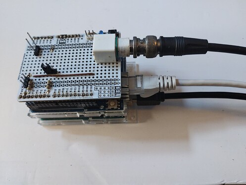

I use right angle PCB mounting BNC sockets, mounted on a prototyping board.
