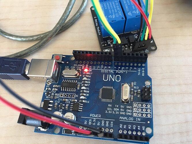

i am an arduino suuuper nooob. I bought my first board to play and get more interested in it.
I have to say this is not an original board, it is a compatible one.
I have a question: why i can't upload my sketch?
this is the message i get while uploading program:

avrdude: ser_open(): can't open device "\.\COM1": Impossibile trovare il file specificato.
avrdude done. Thank you.
I followed the instruction and i select the arduino/genuino UNO board from list.
I also installed the ARDUINO UNO driver in Windows 7 (x64) Device Manager

Select the port of your Arduino from the Tools > Port menu. If the menu is disabled or the port of your Arduino is not shown on the menu:
  • You may need to install the driver for your Arduino
  • You may be using a charge only USB cable
  • You may be using a defective USB cable
  • You may need to switch from using a USB 3.0 port to a USB 2.0 port on your computer
Thanks for your reply.
Actually, USB cable was connected to usb3.0 and i moved to a 2.0 port, but the problem still exist. I guess it is a driver issue. I tried many drivers but the answer is the same:
unable to start the device (cod.10).
PS: usb cable is a printer cable...
SOLVED!!!! i found this page:
Thanks for your time!
bye
Marco
thanks gund77! it was a problem and solved by you. thanks a lot.
(when i upgraded from windows 10 to windows 10 creators my old usb drivers -i suppose- were reset to original. now its normal. arduino sketches are uploaded successifully)
