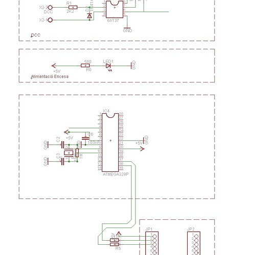

I'm building a project in Arduino.
I used the Arduino UNO R3 and a Board named DFPlayer.
The shield is diy
It works very well
As I use very few features of the Arduino I planed to buy the AT328P from Atmel and make a DIY board, but I don't know if it will work
I attach the eagle schematic of my new board. The crystal is a Standard low cost EBAY 16Mhz crystal it will work or I've to put a 1M resistor (R7) through its legs as in Arduiono UNO?
I've to put a capacitor of 100nF through 5V in and GND of the AT328P as near as possible of the PIN number 7 and 8
Thank you very much
What is JP1? Is that an FTDI connector for serial programming? If so, it's connected to the wrong pins, and I can't tell if ground is connected.
I've never put the 1M resistor across the crystal.
Why is the top and bottom of the schematic cut off?
I can upload to Dropbox
JP1 and JP2 are the PINS from DFPlayer
