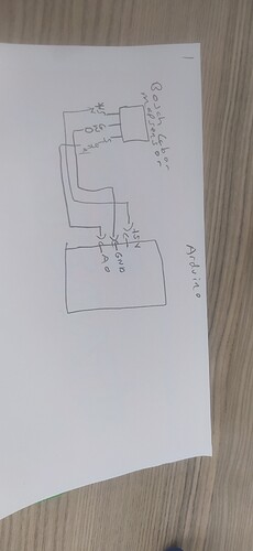

How is the sensor powered (post a circuit diagram and/or picture).
Leo..
I post the pıcture of my comnnectıon
and I dont understand what you say about dısconnectıng the sensor and connectıng a0 to 5v pin ?

Couple of points :
  • I believe these are absolute transducers , so if you applying pressure ; it’s 3bar gauge full scale , that maybe affecting your maths in your sketch - the “offset” is atmospheric pressure ( the first of your 4 bars)
  • how are you measuring pressure ? You need an accurate reference For this

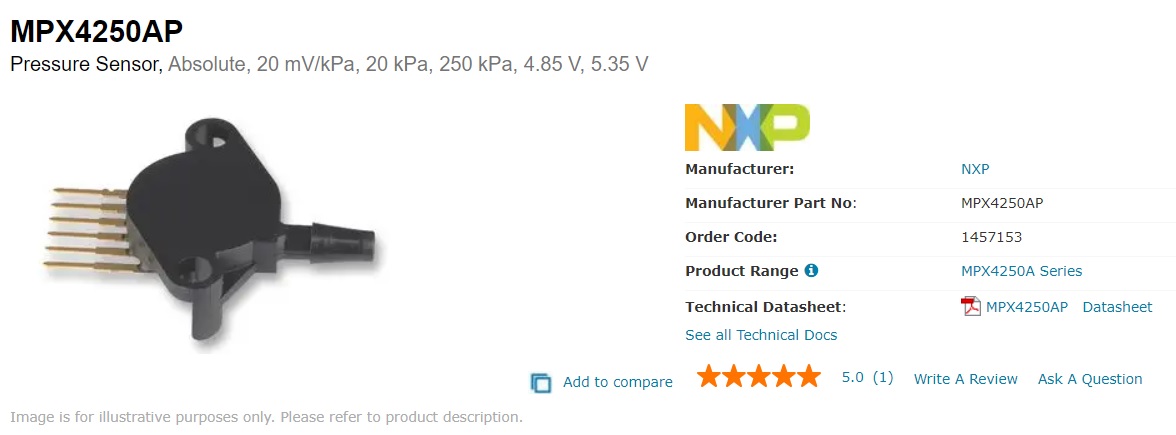

What is the full part number of the 4250?
MPX4250D
MPX4250GP
MPX4250P
mpx4250ap

The MPX4250 is a 250kPa (2.5bar) sensor, so it never can measure 4 bar.
Offset and span in the code might have to be adjusted.
Leo..

The MPX4250AP is as the suffix infers an ABOSLUTE PRESSURE sensor.
If your is the this model then the max diff-pressure is 250kPa == 2.5Bar
So you will not get 4Bar.
Datasheet attached.
2291654.pdf (183.5 KB)

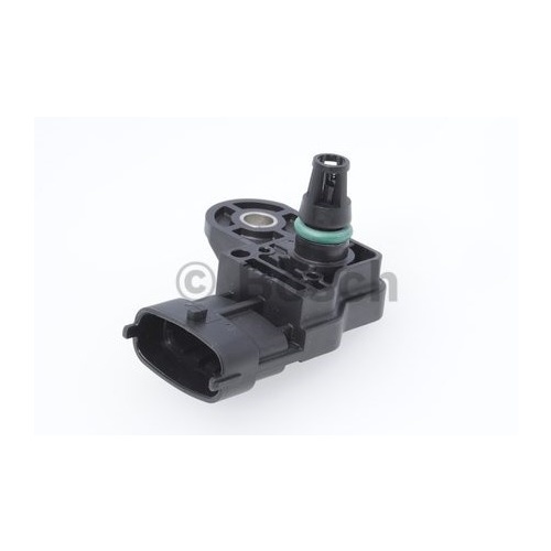

What is the complete part number of your Bosch sensor?
Can you please post a link to data/specs?
Thanks.. Tom... :grinning: :+1: :coffee: :australia:
bosch
0 281 0006 0077 PART NUMBER
made ın germaN
So you have this:
0281006051
