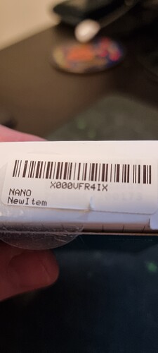

I'm starting to think that this was a return that somebody screwed up after trying to flash with an old version of the bootloader, it went back to Ardiuno, somebody plugged it in, uploaded blink, shrugged their shoulders, and repackaged it and sent it back to the Amazon stores.
I've now looked even closer at the box, and there is a label stuck over the original.
You have bought a clone, non genuine Arduino.

This label is used to allow internal inventory control by Amazon for the products that use their FBA (Fulfillment By Amazon) service, which is used for all Amazon Prime orders.
With this service, a seller ships a bulk lot of a product to an Amazon warehouse and then Amazon takes care of shipping to the final customers when they order the product. Amazon requires a "Fulfillment Network Stock Keeping Unit" (FNSKU) code be attached to each product, which is the alphanumeric and bar code you see on the label. This is different from the standard SKU because it must identify the seller who owns that unit (Amazon Marketplace allows multiple sellers to list the same product) in addition to the product model.
Somehow I doubt Arduino, who the official invoice is from.. would sell me a clone :wink:
