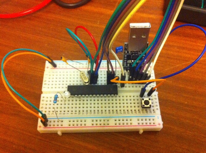

I made the standard breadboard Arduino. An ATMega328 with a 16Mhz crystal and a LED on pin 13. I used the standard Uno optiboot bootloader from my Arduino IDE install. I'm currently using a no name Chinese CP2102 based USB to UART bridge.
The problem I have is that uploads from the IDE are unreliable. More often than not the upload will fail with "avrdude: stk500_recv(): programmer is not responding". But the thing is that it does actually work occasionally. I added a reset switch and of course if I hit that just before the upload it works every time. I do have a 0.18uF capacitor between the DTR pin on the CP2102 dongle and the chip reset pin.
Any ideas as to what the problem might be? I assume it's some sort of timing issue. I have the ability to recompile optiboot if needed but I'm not sure what to tweak. Attached is a picture of the setup. Any ideas welcome.
You forgot the 10k pull-up on the reset pin.
Where are your de-coupling capacitors?

Not to mention the ground and Vcc to the other side of the chip.
I assumed they were the blue and green wires.

Well I was following this tutorial which doesn't use them. But I'm willing to try anything.

Sorry, should have mentioned that. With a 10K between RST and the positive rail on the board I have the same problem. But worse, the reset button method won't work. But I'm reading Nick Gammon's article on all this and will report back if I get it working.

Following Nick's build worked. The addition of decoupling caps and the 10k resistor did the trick. So many breadboard recipes skip the caps and the pullup. I wonder how many frustrated people gave up.
