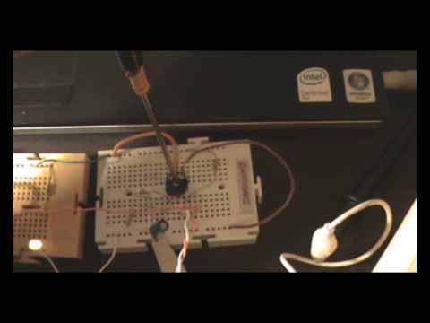

  1. a piezo wired up like this:
    http://leucos.lstilde.org/wp/2009/06/piezo-transducer-signal-conditioning/
  2. an electret microphone (the panasonic wm-61a) wired up like this:
    http://www.chris3000.com/archive/breath-sensor/

With the piezo I got something if I tapped/thumped it, but nothing at all from breathing. Even loudly. I had originally tested a piezo because of this:
http://www.dtic.upf.edu/~jlozano/interfaces/blow_sensor.html
I didn't test it with the schematic he has posted, but when using a piezo with some signal conditioning, it didn't seem fit for purpose.
With the microphone I got nothing at all happening. I'm assuming this is because the microphone wasn't getting enough power to produce audio. I just had the mic capsule plugged directly into the breadboard and wired up with 5v only.

Go with the condensor mic - only wire it up correctly.
"With the microphone I got nothing at all happening. I'm assuming this is because the microphone wasn't getting enough power to produce audio. I just had the mic capsule plugged directly into the breadboard and wired up with 5v only. "
I use them to record music, but wired up like this, feeding an amplifier, for output centered around ground. You'll probably want to have the output go across two 100K resisters (+5V-100k-100K-Gnd, connect mic & arduino to the middle junction) for steady 2.5V output that can go 0-5V.

You have to amplify signal from the mic, at least 100x.
Look at sparkfun web site, they have electret mic breadboard with OPA on it.
Other option I could think, is temperature sensor that initially worm up by nearby resistor,
so when you blow on it, it getting colder. Depends on "initial" temperature (100 - 150 C degree)
it could be very sensitive.
Oh yeah, I forgot about the spark fun mic/amp. Go with that one.
If you goal is to have the brightness depend on how hard you blow on the sensor, and you don't mind having to put your lips around a tube, to blow into it effectively, a good answer would be...
$25 for a device that you wire to 5v, GND and an analog input. To quote from site....
The currently stocked MPXV700xDP sensors are five volt sensors and the outputs float at 2.5 volts, with no pressure on the input. Suction will cause the sensor to output lower voltages, pressure will cause it to output higher voltages.
