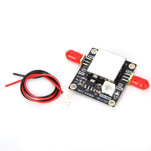

Hello Sir, I want to know is it possible to build a mobile phone detector based on this module. I want it able to read RF transmit by the mobile phone.
This is AD8318 RF power detector.

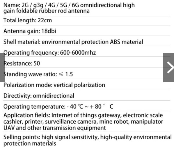

For an antenna I use this

Yes, that seems to the only purpose for the device.
Do you have suggestion what i should study more about this project?.
No, I suggest you actually TEST what you are considering, rather than guessing.

An active mobile phone will indeed exhibit some level of radio signals
One possible approach is to monitor radio frequency signals, such as cellular, Wi-Fi or Bluetooth. By monitoring these signals and detecting unique markers associated with smartphones, one could infer their presence.
A spectrum analyzer is commonly used to capture RF signals - would be probably where to start.

Perhaps the greatest problem is actually detecting the random, widely varied, response of a cell phone to a "ping" from the local tower. Most of the time, your cell phone is just listening for a ping from the tower.
The second problem you have is determining the exact frequencies used by each cell phone service provider. Once your have that you can program your device to scan those frequencies and try and catch a responses to a ping.
My office PC speakers would pick up any SMS, especially Blackberry. A cheap AM radio will probably do the same.
