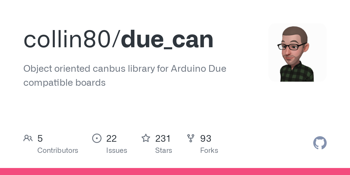

EDIT [01-08-15]:
Link of latest version of Arduino DUE CAN library and examples:
https://github.com/collin80/due_can
