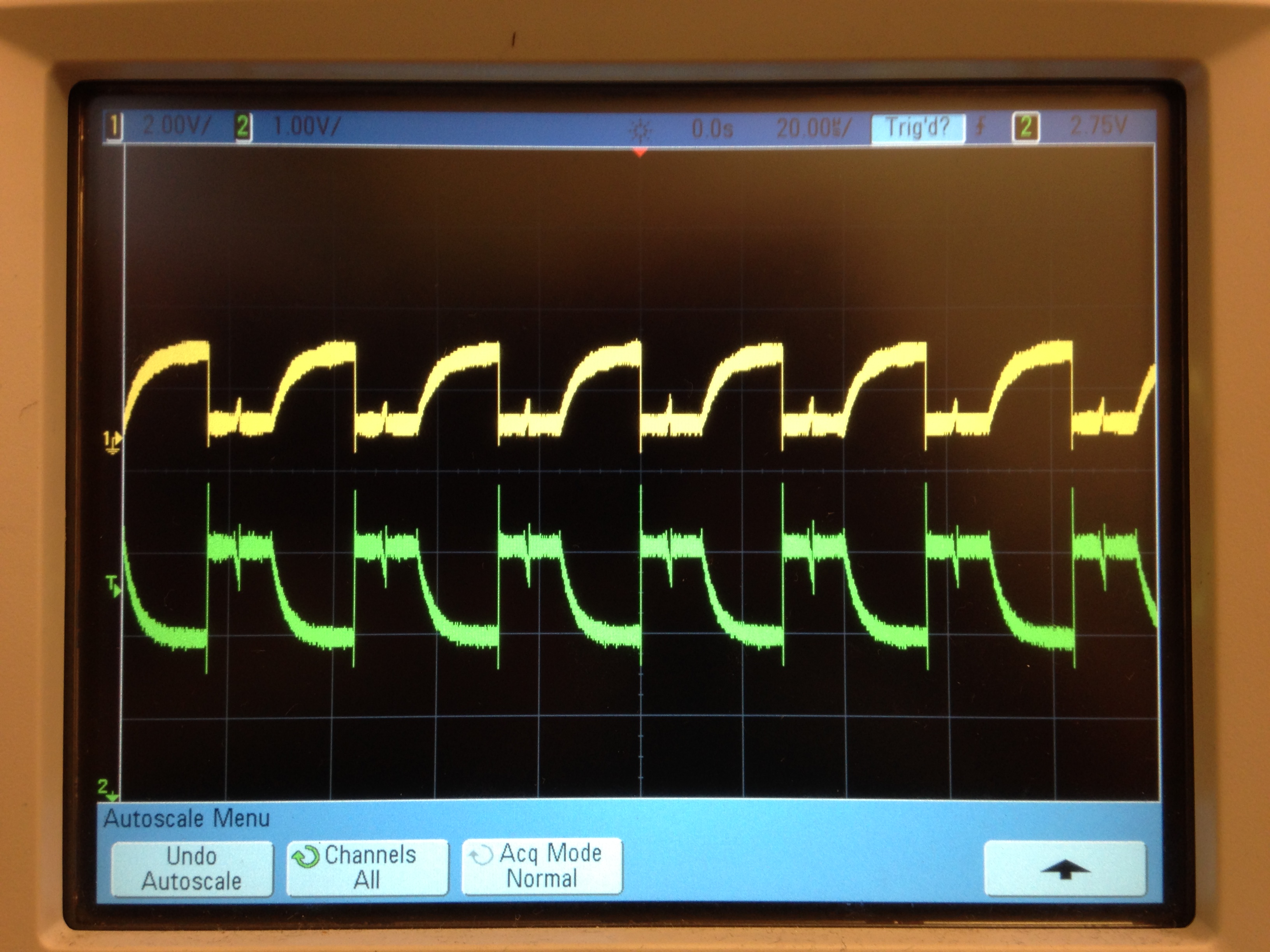

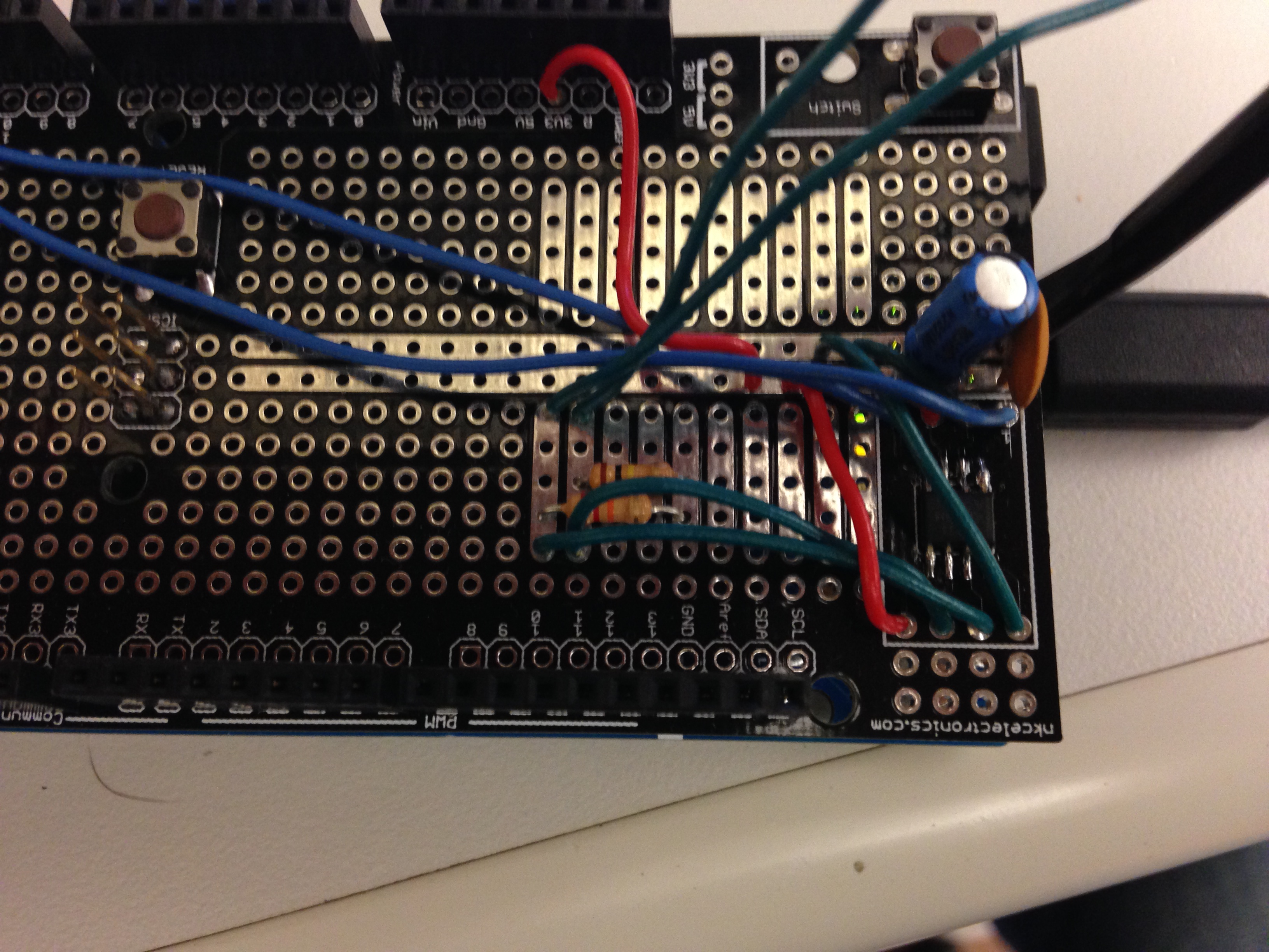

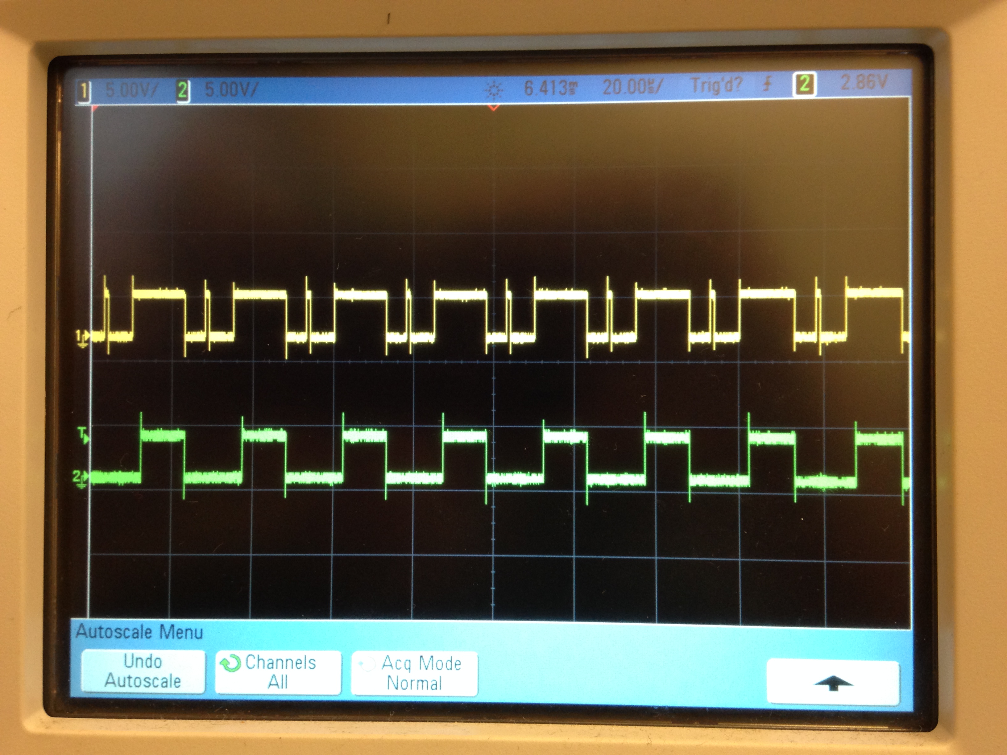

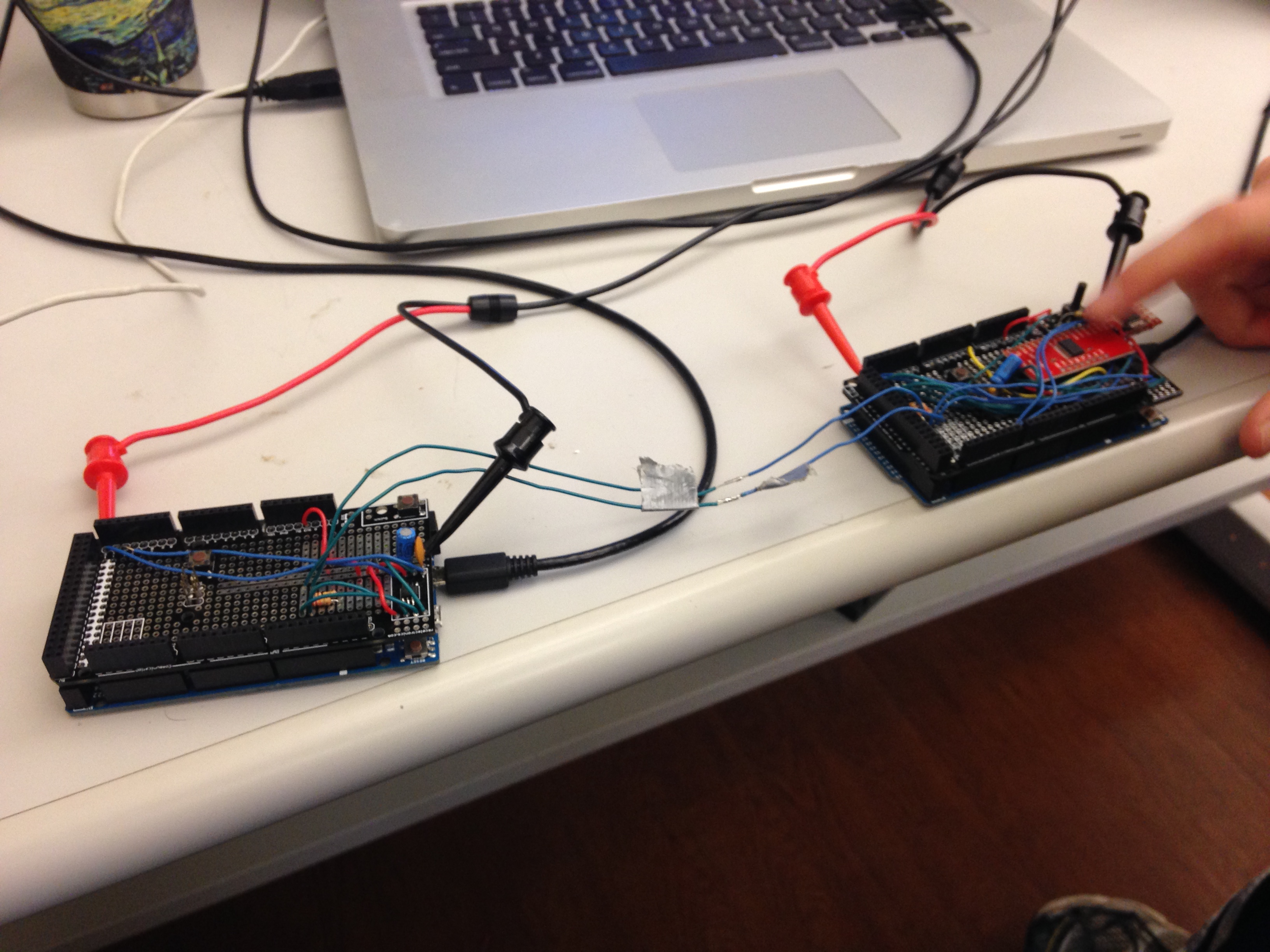

I sent a message to Palliser but I figured I'd post here as well:
I'm working on using the due can library to read the can bus of a battery management system and motor controllers for an electric racecar. I've built two shields with transceivers which appear to be functional. My setup is two dues, each using CAN0, or the labeled cantx and canrx lines. One is set up to transmit over the bus and the other is set up to receive. The setup looks like this:
When running my code, it would seem to me from the oscilloscope that the bus is only clocking or syncing and not actually sending any data.
When probes are hooked to the pins on the arduino (cantx on transmitter, canrx on receiver) the output looks like so:
And canh and canl lines look like so:
At this point, I'm stuck. I can't figure out what is wrong with my code or if there is something wrong with my physical setup. Can anyone see anything wrong here?
Thanks for your help,
Shep
Anybody?
Here's my CAN_RX code if that helps (can't find the CAN_TX at the moment, I will have to search around for that if it's needed):

Your CANH/L signals look awful. There is way too much slope on those signals. Are you terminating each end with 120 ohm resistors? Your pictures look to have something like 100k and 22k resistors (it's hard for me to make out all the colors) which doesn't seem to make sense unless I'm looking at the wrong thing.
Collin80:
Looks like that's the error... accidentally read that off the schematic as a 120k (didn't have any in stock which is why I had the 120k+22k series combo). I'll have to solder in a 120ohm and see if it works.
Shep
