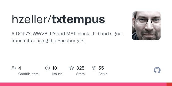

I think I have similar need.
My receivers are not able to get DCF77 signal in my home (they work in other location).
I would like to use something like D1 mini wifi ESP8266 to get time from NTP and convert it into DCF77 signal.
I had some devices with DCF receiver and would like to keep them in house.
I have some doubts about antenna. I read a little bit and have an overview like 6v6gt wrote: range is about 50cm and I would like to have range about 10m (will be grate).
For now I had only idea like:
NTP server - some module (ESP8266/Raspberry Pi/something else) - antenna - my receivers.
It will be good to have possibility connect via WI-FI to home network and have possibility to place it into central place without cables.
I'm not sure esp8266 can generate the required frequency, but Rasp Pi can.
Check the above there is the solution. The only thing is antenna/amplifier for 10m :slight_smile:
