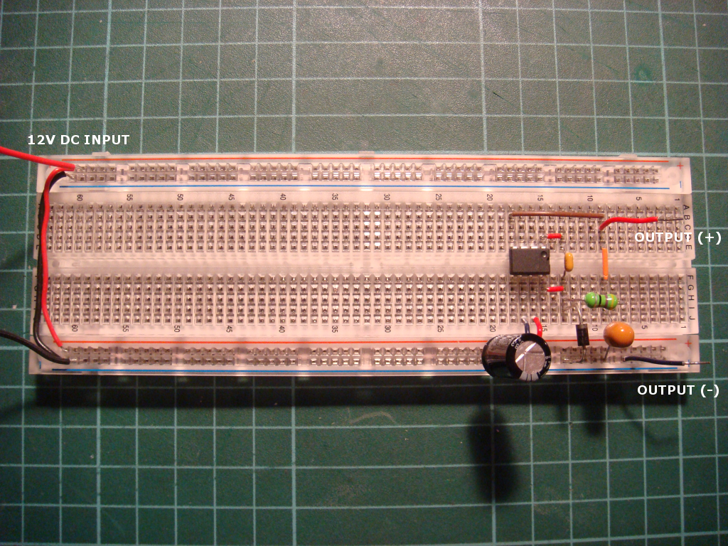

Hello Team,
Just checked with a dummy load, turned out the circuit only gives 200mA. What could be the issue? As we mentioned before out capacitors are not to spec. Will that affect the current output?
Thanks, BTFdev

Yes but that was a schematic -- what is also important is physical placement of components and wiring. That is the thing that would be interesting to see.

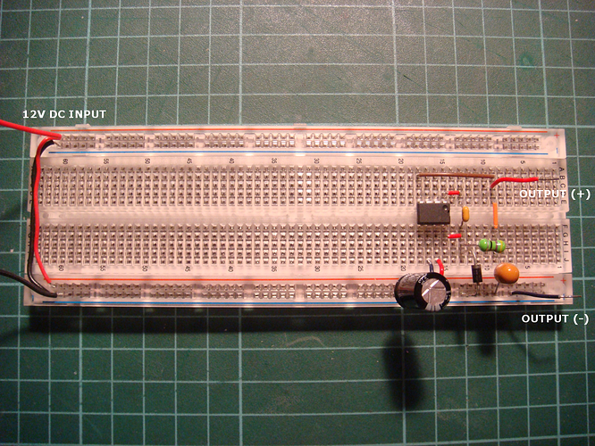

The picture of circuit layout attached.

I'm beating RC to the punch** , but the datasheet shows that all of the components should be grounded to/at a central point. It's really particular and you need to concentrate on minimising component leads, too. There's a sample layout (at least in my datasheet). The breadboard is OK for low-power checkout, but for maximum performance a circuitboard is required. If nothing else, "deadbug" it.
** (I'd been lurking all along thinking that what you did was what you must've been doing.)
That inductor dosen't look like it is man enough to supply the current. You need one with a core that dosn't saturate.
Also like r_p says the layout is no where good enough for a switch mode power supply. You need a PCB and a correctly designed one as well.

Last night, we ended up removing everything from the breadboard, re-assemble everything from scratch on another portion of breadboard. Son of a gun, it worked.
We believe many things went wrong here such as layout, all caps, diode are at their full leads. We noticed during removal that some leads when inserted into breadboard, they went pass the contact rail underneath and slipped to somewhere else. There might be a short circuit somewhere, the circuit was giving a fluctuating 1.2V before we took everything out.
Newbie mistake. We are all good now.
