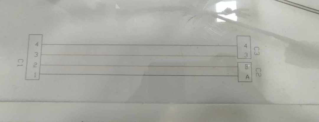

yes im working on small cables either they have 2 , 3 or 4 connectors
heres an example im working on
  • Why are you making this ?
    im doing an internship where they suggested for me to do a cable tester
1st image its shows the mapping of the wire (drawing ) ,and 2nd image the wire im working on

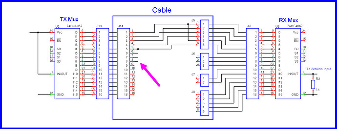

  • 74HC4067 will work from Vcc = 2V thru 6 Volts, this is good for a 3V3 ESP32.
  • Your schematic showing a TX 4067 and a RX 4067 is reasonable; can obviously be expanded.
  • A one to one wire connection between I0-I15 of the multiplexors is made.
  • On a master cable:
    TX Mux: Place a HIGH/LOW on the MUX pin #1 (INPUT), select an output with S0-S3.
    RX Mux: Scan all the inputs on the RX Mux using S0-S3, monitor pin #1 (OUTPUT).
    Repeat until all wires are fingerprinted.
  • Above creates a finger print for that cable . . .
  • What exactly do you need help with ?
Your component list needs to include a keyboard so you can tell your program which exact cable you are testing!
  • Let's assume we have this schematic.
  • Let's assume the cable is supposed to be 1 to 1 wiring.
  • We walk a HIGH down the pins of the TX Mux, I0-I15
  • We make 16 reads to assemble a RX image as in the Cable101 array.
  • If this is a 1 to 1 cable, what is the problem with the cable ?

  • Can we simply tie IN/OUT on the TX Mux to Vcc ?
  • Let's say we had a 6 wire cable.
  • What would the RX array look like ?
  • Would you ever have a cable where ex. pin 7 is connected to pin 8 on the TX side ? :thinking:
    Or for that matter on the RX side ?
no, you wouldn't normally have a situation where pin 7 is connected to pin 8 on the same side (TX or RX)
or having a splice
its just follows the mapping that i showed you earlier

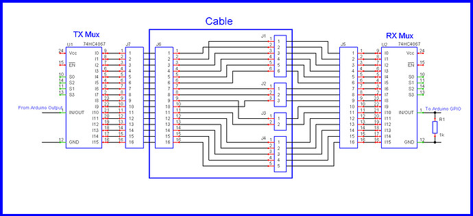

  • Since your cabling is very simple, a resistor ladder would be appropriate.
  • There are R2R resistor networks available.
EDIT
Updated schematic.
so i should add R2R ladder resistor network on the RX side of multiplxer , and my schematic is good to go ?
