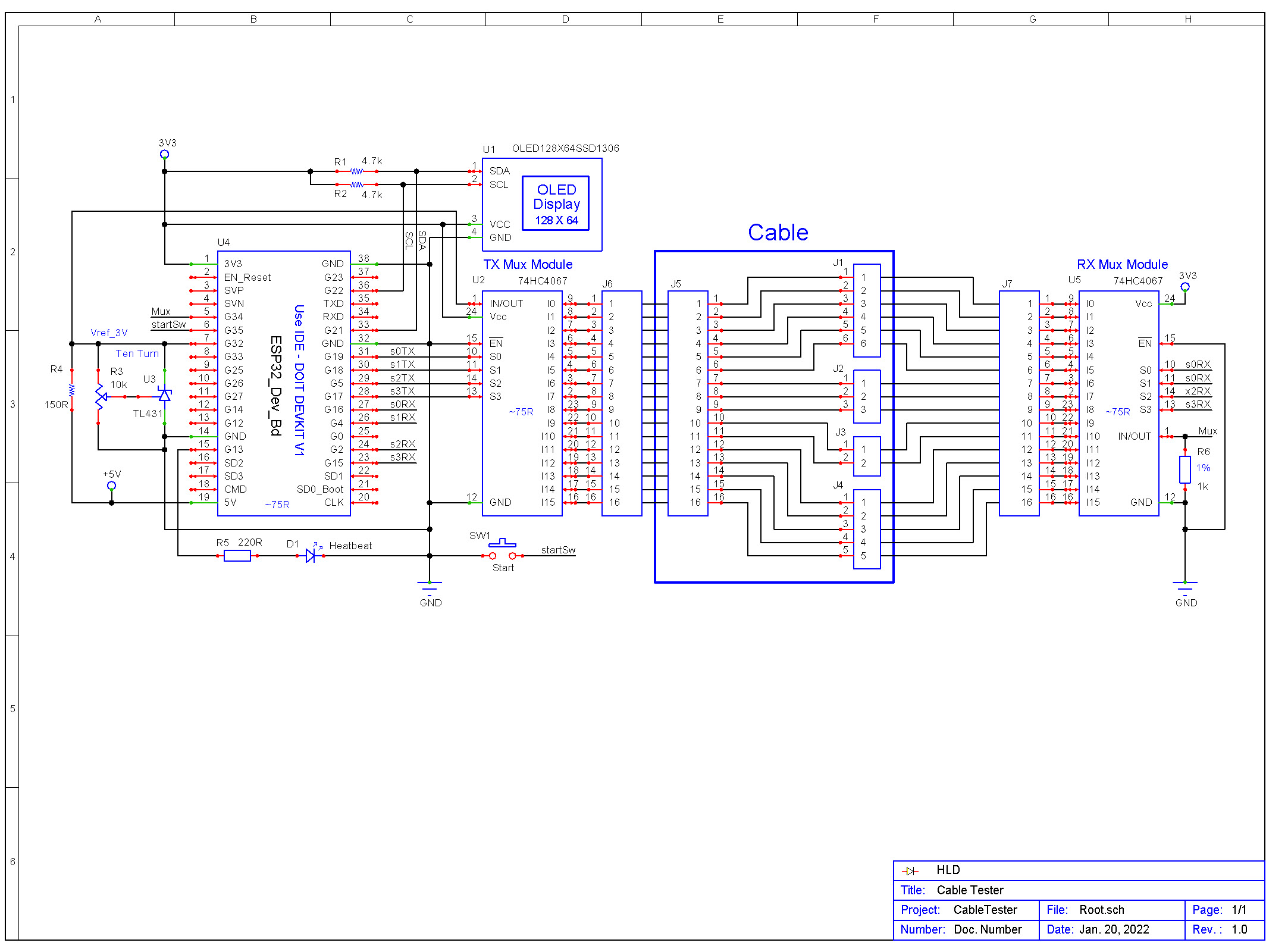

  • This was discussed in March and April, more wires requires extra 74HC4067 muxes.
Mega2560 has 25 pins available.
For 25 wires, with short circuit and continuity detection, 50 Arduino/GPIO pins are, as far as I see, required.
