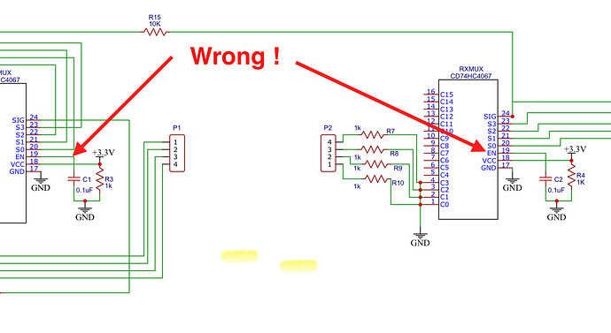

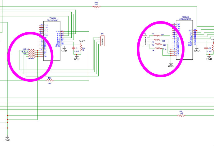

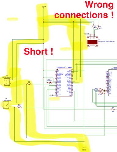

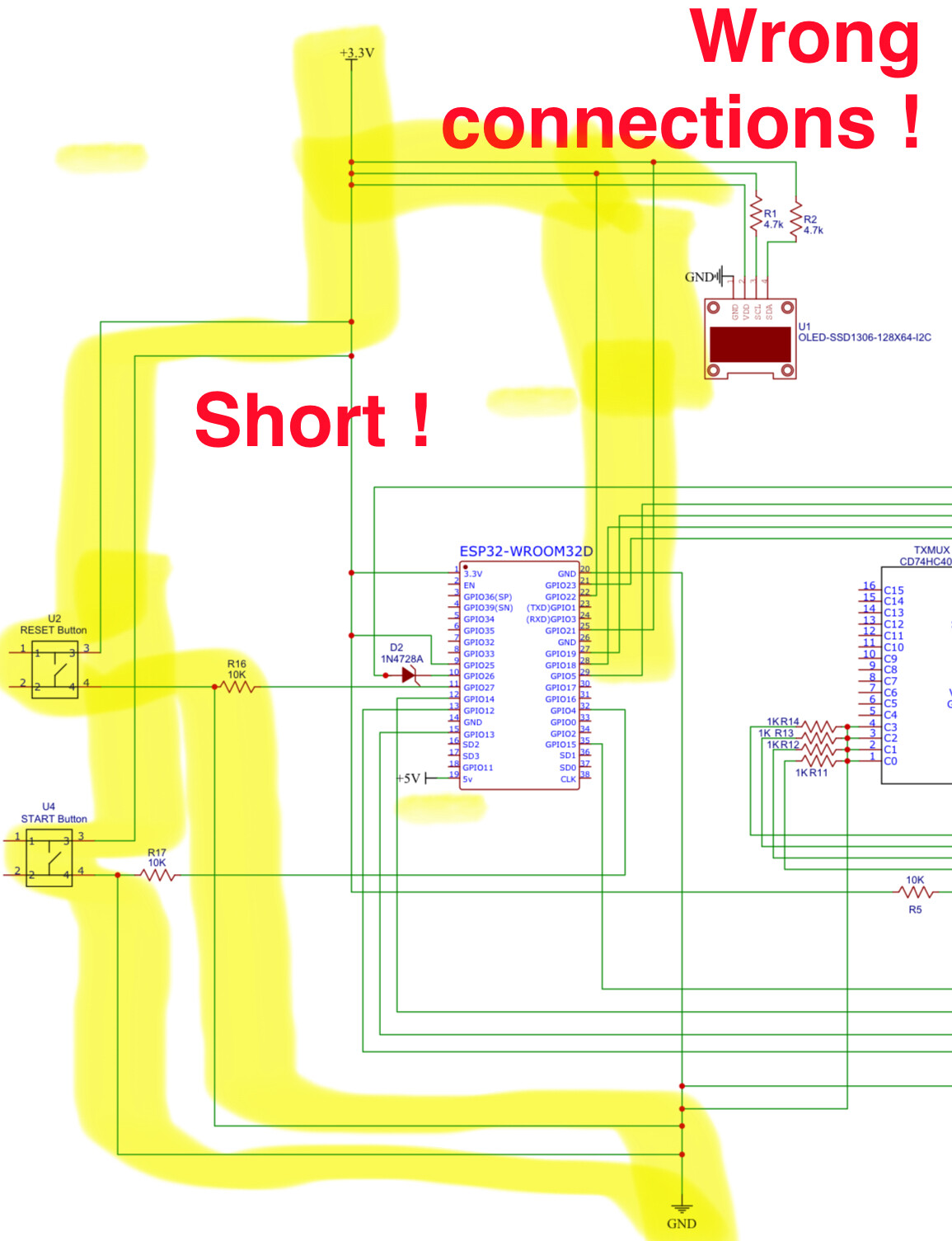

Hey everyone, I'm still struggling with implementing the resistance test for my project.it's the only part I haven’t been able to figure out yet. I think the issue is mainly with the hardware setup.
I was considering adding a dedicated push button specifically for triggering the resistance test, but I’m not sure how to make it work. Someone suggested connecting a 100-ohm resistor to ground through the sender multiplexer, but I’m still confused about how to proceed.
Schematic_DIY-Harness-Tester_2025-04-17.pdf (83,4 Ko)
  • Sorry, you are just not paying attention to even the basic things. :roll_eyes:
  • Post #44 is a functional working example, put the effort in and learn from it.
  • You are making serious mistakes and are not taking direction.
    Stop and clean up all your mistakes before proceeding.
  • Your schematic needs to be accurate, these connections make no sense.
