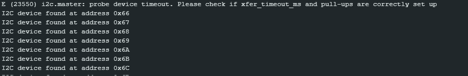

Hey everyone, I tested it again today and ran the I2C scanner. This time, it showed different results. However, it did work when I powered the device with 3.3V and used address 0x27.
  • Highly recommend you use an OLED Display Module 128x64 Pixel SH1106 with the ESP.
Thanks Larry , i will get the SSD1306, it support 3.3v i reckon
Yes
  • Are you getting the SH1106 or the SSD1306 ?
