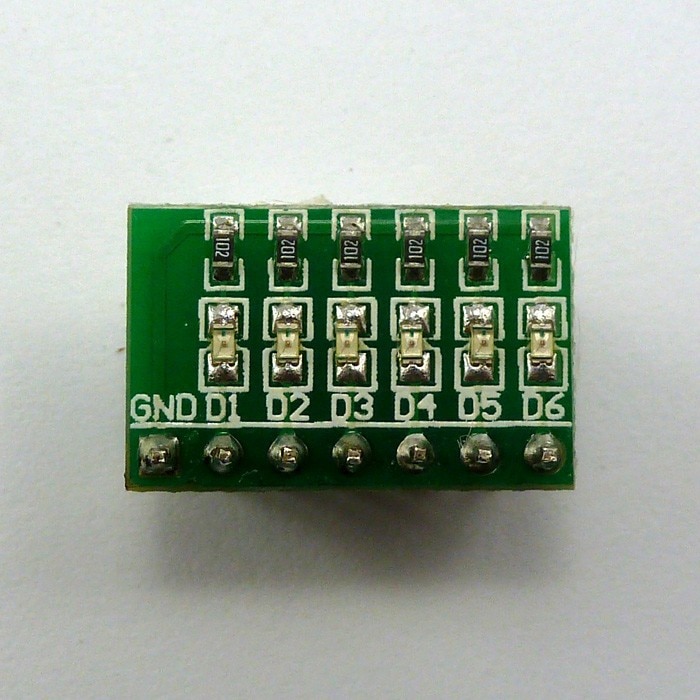

I bought these two handy things to aide with quick prototyping and troubleshooting. One is a series of LEDs and appropriate resistors mounted on PCB. The other is a similar arrangement with momentary switches. I've been using them happily for months, pushed in to a breadboard.
But earlier today I saw another use case for them: Pushed directly into the pins of an Uno.
And that made me think: Would those LEDs even work? In this photo, the GND pin of the switch module is connected to GND on the UNO. That's great. But it looks like GND of the LED module is pushed into maybe 5 or 6 of the UNO.
So... apologies if this is a stupid question. It is, at least a genuine one: I don't know the answer or where to find it:
Can any Arduino pin be 'used as ground'?
(Underlying question: Can LEDs be used with an Arduino in the configuration shown in this photo?)

Digital or analog output pin cannot be used as GND.
For a given project it can be used with the LOW which is very close to the GND value.
If you use some digital pin like GND for these LEDs (6), the sum of the currents of these LEDs passed through only one pin and it could exceed the maximum value supported by the pin and could damage it.
Think of the pin labelled 'GND' on the LED PCB; in reality that will be the common cathode connection for all the LEDs.
An Arduino pin can be the common cathode of an LED array as long as the maximum current of the IO pin is not exceeded. This wiring is how LED matrixes work.

Each of the outputs going to D1 to D6 is supplying 10 ma (typical current, not sure what you have).
Normally the common (aka ground) would go to the ground / common pin on the UNO which can return all the current the processor output could supply. However since you common is going to a digital pin, That pin must be commanded LOW and will take the full 60ma which is greater that its rating.

Take a look at the UNO pinouts. The LED board, at least, is designed so the GND pin will align with GND on the UNO and the LED pins can then be driven by D8-D13.
You could use the switch board with an I/O pin substituted for a GND, if you are careful to never enable the switch inputs as OUTPUT.
So just swap the position of your boards, as they are shown in your picture.

You have a six LED board using 1k resistors ("102" as I read the photo).
Assuming 2.5 V voltage drop on the yellow LEDs, each will draw 2.5 mA. the LEDs are highly efficient, you would not want them to be any brighter! Six of these all lit will take 15 mA. Well within the ratings of a UNO - but not necessarily some of the other variants.
So no problem at all in this particular situation. I have a couple of the eight LED multicoloured modules - but haven't done much with them and have them put away somewhere I can't find in a hurry. And I don't use UNOs much as they are so clumsy.
Applies irrespective of how you connect the common pin. :astonished: In fact, connecting a HIGH and a LOW output pin is likely to cause less damage than connecting a HIGH output pin directly to ground! :thinking:

That's pretty funny. It's a vendor image, not OP image that does not show the intended connection. Here is some code, direct from AliExpress to illustrate:
  Arduiuo_6led

What if the unseen code multiplexes the LEDs so that no two LEDs would be on at a time?
What 60 mA? :roll_eyes:
Of course there are many acceptable scenarios. Still the OP should be helped to understand the way the common comes into play in such a configuration.
As it as been pointed out; in this case each diode current is low enough to not be an issue. Still it is not an ideal situation in general.
