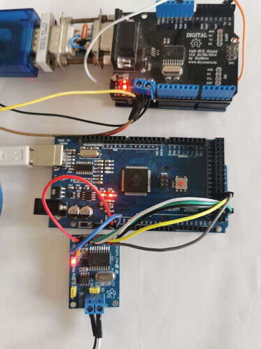

Hello,
I need help with my CAN bus setup. I have two nodes (Arduino Uno + MCP2515) working perfectly both initialize successfully and communicate without issues.
Now I’ve added a third node using Mega + MCP2515, but the terminal keeps showing this error:
Entering Configuration Mode Failure...
the other two nodes show:
Entering Configuration Mode Successful!
Setting Baudrate Successful!
MCP2515 Initialized Successfully!
I’ve already swapped the MCP2515 module with the Uno and verified that the module itself is working fine. I am using the MCP2515 module with an onboard 8 MHz crystal. So I believe the issue could be either with the wiring or the Mega code.
I’m sharing both the code and the wiring picture for this third node below. Could you please take a look and let me know if you spot any issue?

@van_der_decken
Did you deactivate the termination resistor on the node in the middle?
When using more than 2 nodes in a can bus setup only the end nodes must have the termination resistor connected.
The resistor on the center nodes can be disconnected by removing the jumper.
Yes, I did deactivate the termination resistor on the middle node.
I understand that in a CAN bus setup, only the two end nodes should have the termination resistors connected, and the middle node should not.
Mega + MCP2515 is one of the end nodes in the CAN bus setup.
Hi, @adrino1
Did you try to configure the Mega with the module disconnected from the bus wires?
Can you please post your code for the UNO version and the Mega version?
I did try configuring the Mega with the module disconnected from the bus wires, but it still fails to enter Configuration Mode.

That message is independent of the CAN buss but it does indicate communication problems with the MCP2515 chip. That indicates you may have a SPI configuration/connection problem. In your picture one of the (I think it is) SPI pins is not connected. The chip will initialize without a CAN buss connected but the SPI must be correct.
I’ve double-checked the wiring, and all SPI pins are properly connected between the Mega and MCP2515. Everything looks fine physically, so I’m now starting to suspect that the issue might be related to the code running on the Mega, or perhaps how the Mega handles SPI differently compared to the Uno.
Unfortunately, I don’t have a third Uno available to test this setup with the same code. If anyone can try running this code on their Mega with MCP2515 and confirm whether it initializes successfully, that would help me narrow down whether it’s a hardware specific issue or code related.

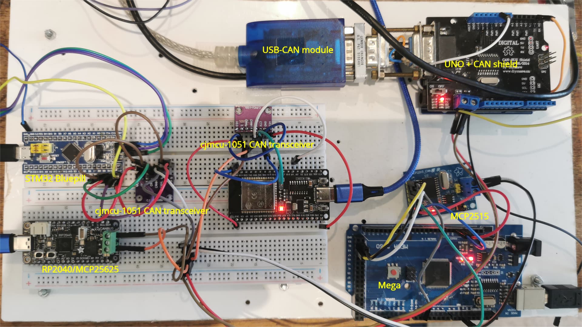

connected a Mega to a MCP2515 and communicating OK over CANbus
Mega code
// Mega MCP2515 CAN send/Receive Example
// Mega <> MCP2515 connections
// MCP2515 INT to Mega  GPIO45
// MCP2515 SCK to Mega  GPIO52 CLK
// MCP2515  SI to Mega  GPIO51 MOSI
// MCP2515  SO to Mega  GPIO50 MISO
// MCP2515  CS to Mega  GPIO53  CS
// MCP2515 GND to Mega  GND
// MCP2515 VCC to Mega  5V

also have an ESP32/TWAI, RP2040/MCP25625 and STM32/MCP2515 in CAN network
EDIT: can you run the CAN loopback test? File>Examples>mcp_can>CAN_loopback
should at least prove the Mega<>SPI communications are working
I ran the CAN_loopback example from the library. I made a few changes in the code to match my setup:
CS pin is connected to 53, so I updated the constructor accordingly.
INT pin is connected to 45
so I selected MCP_8MHZ
Error Initializing MCP2515...
MCP2515 Library Loopback Example...
Standard ID: 0x000       DLC: 0  Data:
I tested with another Mega board and changed the INT pin to 2—now everything works fine, and the MCP2515 initializes successfully.
So it looks like the issue was with the Mega board

you mentioned using ESP32, could you please share the code you’re using for that setup? I’d like to see how you’ve configured it
using the [Two-Wire Automotive Interface (TWAI)] interface(https://docs.espressif.com/projects/esp-idf/en/stable/esp32/api-reference/peripherals/twai.html)
