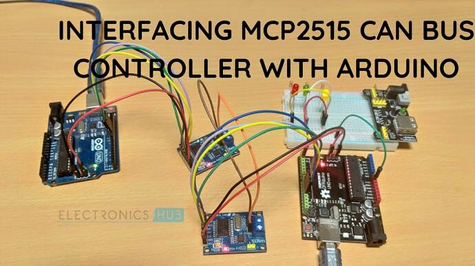

Have this setup shown with these link using a MCP2515 Can module connected

I did notice that my boards not the same as the ones from image.
So guessing that are a clone, so could that be an issue ?
Fond the issue: Was hardware, was lose GND or POWER wire on one of the boards.
Plus checked the terminator resistors on the can lines that where bridged.

Issue was hardware,
GND or POWER on one of them was causing some randomness
Solved and have messaged going two and from now.
So thing to check was that leads all on correctly.
And that have the terminators on the CAN bus lines.
