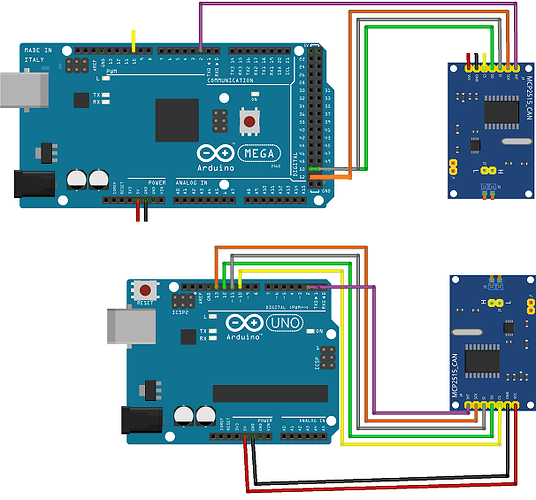

Same CAN hardware (MCP2515), same code,
same car (OBD2 data over CAN, via DLC connector)
same library <CAN_BUS_Shield-master>
Only difference is the MEGA and UNO.
But why are the scanned values different?
Scanned data below.
Thank you for any tips!

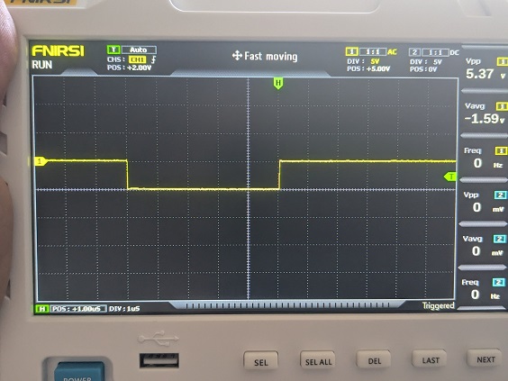

I suspect the real culprit is CPU overload—Serial.print() is surprisingly expensive in time. To pinpoint exactly how long your routines take, try this low-overhead timing method:
Scope-based timing
    Pick an unused digital pin and hook it up to your oscilloscope.
    In code, set that pin HIGH at the very start of the function you want to time, and LOW when it finishes.
    The oscilloscope will display a pulse whose width is the exact execution time, without the extra overhead of millis() or similar.

There's no 'detectable" change in time with the short amount of code listed. About 5 microseconds to complete the loop() using the UNO.
For those that want to know the difference between 30 "IF" statements vs "IF ELSE", I uploaded some junk code and measured the time. There's a
savings of half a microsecond when the processor checks 30 lines of "IF" vs "ELSE IF".

Did you use the same wiring (actual wires) for the UNO and the Mega? If you are using dupont style jumper wires, the wire can break inside the insulation or at the connector itself.

I'm finally able to update, with the following summary:
Nothing seemed to work with wiring updates, baud changes, etc. , so
an alternate (NEW) Mega2560 was used.
This seemed to be part of the issue, but the MCP2515 Module only worked
at 1 Mbps, with a chip select of 10
Adding a SEEED Studio, CAN Shield to the code in the OP, works fine
at any CAN network speed, by relocating pins 11, 12, 13 to pins
51, 50, 52 (respectively)
Now the question is, why won't the MCP2515 & MEGA2560 combo work at
anything but 1Mbps?
