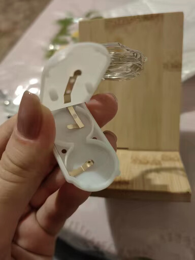

I'd like to use these Fairy lights powered by 2 CR2032 batteries as a sunrise light alarm / dimmable nightstand lamp.
My plan is to cut the wires so the LEDs are split from the battery box, then connect everything back to the Arduino with some potentiometer and transistor in between.
Is it something reasonable?
What would be the safety considerations?

From what I can see, these are just lights and a 3V power supply. Replacing the two coin cell power supply with an Arduino PWM (for on/off and dimming) pin controlling a MOSFET should work. Finding a 3.3V MOSFET will be a challenge but doable.
You will need to find out which wire is positive and which is negative.
Do you have a voltmeter, DMM multimeter or something to measute voltage?

Before you cut the wires, make a long mark with a pen or marker on one of the wires. Make sure the batteries are removed before you cut the wires. Cut the wires so that you can see the mark on both sides of the cut.
Strip the wires on the battery pack, put in the batteries and measure the voltage between the two wires. One way it will be positive and the other will be negative. When you measure positive then the wire that is connected to the meter positive lead will be the LED positive side. Just note if it's the marked or un-marked wire.
After you find which is the positive, connect one end of a 220Ω resistor to the positive wire and the other end of the resistor to any Arduino pin. Connect the other wire to the Arduino GND.

If you can take some close up pictures of the wires and battery pack, we might be able to see which is the positive lead.
