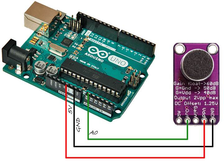

So yes, you can power the module using 5.0 volts. Using an Arduino Uno Rev3 as an example:
Make it like the picture. :slight_smile:
