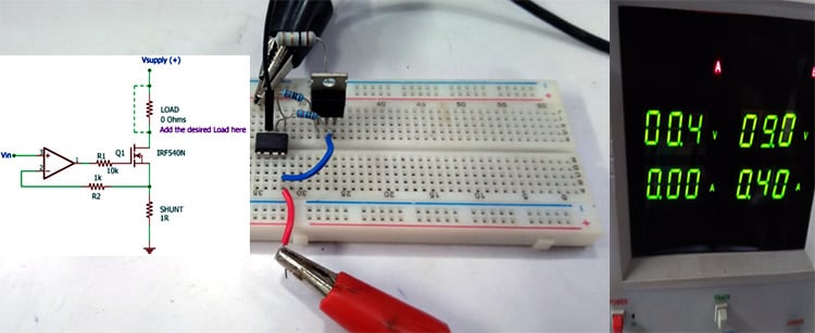

What you describe is a voltage controlled current source, which is trivial to make using an op amp. A web search will find example circuits.

So the only way to make the collector current dependant on the Vcc source in a predictable manner is to to use an op-amp?

It is the simplest way.

You show a constant current ON/OFF source, while the OP wants a voltage controlled current source.

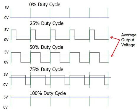

Let me explain it for the OP.
PWM stands for Pulse Width Modulation. It's a technique used to simulate an analog signal using digital means. It works by switching a digital signal (on/off) on and off at a very high frequency and varying the proportion of time the signal is on versus off β€” this proportion is called the duty cycle.
Key Concepts:
Duty Cycle: The percentage of time the signal is "on" during one cycle.
    100% duty cycle: always on
    50% duty cycle: on half the time, off half the time
    0% duty cycle: always off
Frequency: How many cycles occur per second (measured in Hz).
Where PWM is Used:
Motor speed control (e.g., in robotics or drones)
LED brightness control
Audio signal generation
Power delivery in DC-DC converters
Communication protocols in microcontrollers
Example:
To dim an LED using PWM:
If the LED is switched on 50% of the time (50% duty cycle), it appears half as bright.
If it’s on 90% of the time, it appears almost fully bright.
