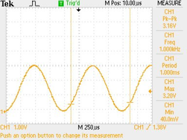

e.g. using an ESP32 (which has two DACs) generating a 1kHz sine wave
