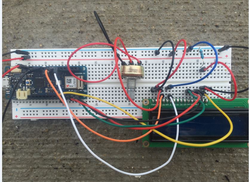

I connected 1010 and LCD per description in Hello World code. Also looked at diagram examples I found online using POT and 220 ohm resister. Made sure “TOOLS” tab had wifi mkr 1010 and port being used. The code compiled and uploaded with no errors. I just get squares. I used the wifi 1010 for other projects and it worked fine. I even tried another 16x2 LCD with same results.
I than moved the same jumpers and connected the Mega2560 (same pins as 1010) to the same LCD. Changed the “TOOLS” tab to MEGA2650. Code complied and upload. HELLO WORLD worked.
Need help to see why HELLO WORLD works with MEGA 2560 and not MKR WIFI 1010 using the same configuration.

There are multiple LCD libraries, each with their own Hello World example, and multiple types of 16x2 LCDs. We need to know which of each you're using.
As well as the code posted according to the instructions, the wiring diagram and preferably, a photograph of your assembly taken outdoors in full daylight (but not sun) so that the details can actually be seen. :grinning:

Attached is the circuit used for Hello World. Data LDC7 - 2, LCD 6 - 3, LCD 5 - 4, LCD - 4 -5
Thanks
attached is the hello world circuit
OP image so we don't have to download it. How to post images.

It looks like there is a bad port on the Arduino 1010 that I bought.
