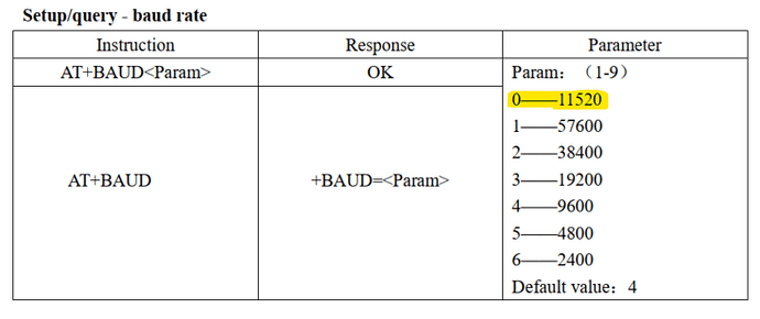

Then I wanted to change the baud rate to 115200. The datasheet is not really clear on this:
It seems that "11520" is just a typo and is should be "115200".
Also, it is written "Param: (1-9)" while the scale goes from 0 to 6.:upside_down_face:
Anyway..... I supposed that I should send "AT+BAUD0". I did it, and now I cannot communicate anymore with the module :roll_eyes:
I tried with Serial1.begin(115200); but also 9600, 11520, 2400 and so on... but now Serial1.readString(); is always empty.
Do you know why? I'm worried that sending "BAUD0" was a bad idea. Any way to do a factory reset via hardware?
