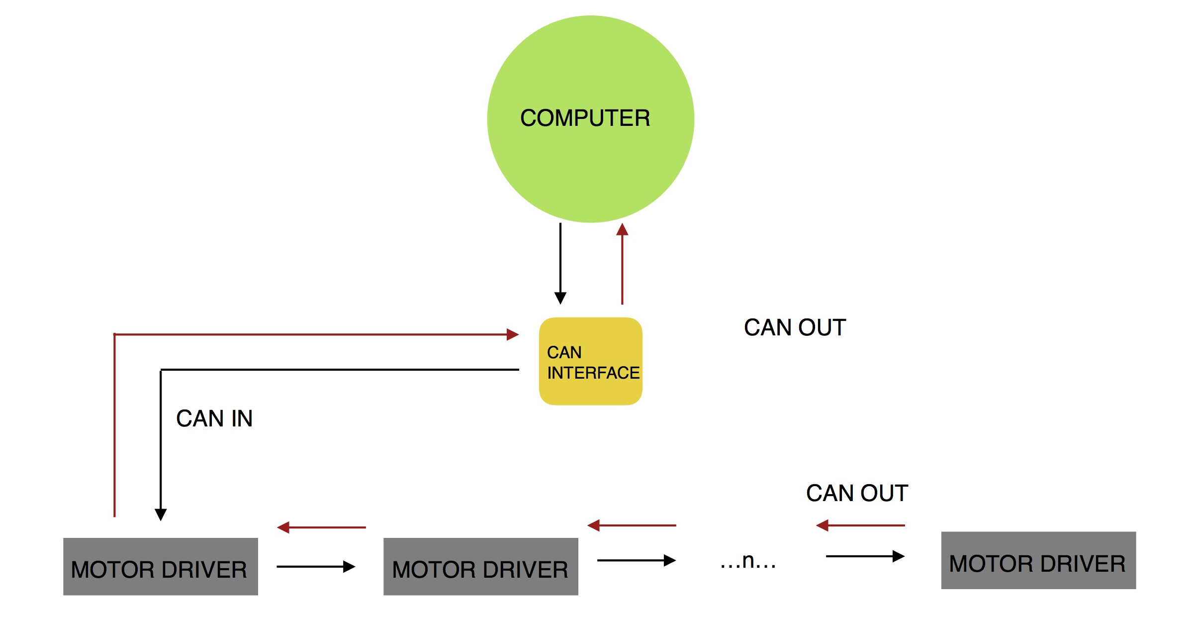

Hi Dyaus292,
I am currently facing the same 'problem' as you.
I have a Nanotec C5-E motor driver and a BLDC motor. I am able to make it run as a standalone app with Nanotec's sample codes (Windows only). However, I am having a hard time wrapping my head around the CANopen communication.
I have consulted with Nanotecs' technical assistants but they are not able to provide me with concrete answers or point me in the right direction. They suggested purchasing the IXXAT USB-to-CAN interface (the compact RJ45 variation). I am still waiting for this to arrive, but I assume it will work with Nanotec's software.
However, I am looking into developing my own software, since I would like to use the motor driver for an interactive installation that will control and monitor potentially 50 of these motor drivers. As mikb55 pointed out, my goal is eventually to daisy change my motor drivers. It will look something like the uploaded image.
So, I am wondering if Dyaus292 came up with a reliable solution using the arduino shield you suggested?
