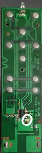

I am trying to decode signals from my ceiling fan's remote. But when I try to decode signals I am not getting any hexadecimal codes from the remote. The code that I am using is certainly working because when I used my speaker's remote, it showed the hexadecimal codes. And, I am sure that the fan's remote is working because my fan is responding to the remote.
An interesting thing that I noted was that the pins of IR emitter on the fan's remote is shorted. Please help.

There are other variables that can come into play here that are more hardware related.
  1. The modulation rate of your fan's remote could be different from the modulation rate of your speaker's remote. There are about 6 different modulation rates and so there are 6 different chips that are used to decode them. What chip are you using?
  2. There are two different IR wavelengths of IR that can be used, normally 960nM and 890nM although I might have got the actual numbers not quite right there. You need to check what wavelength of IR your remote is expecting, and again there are different decoding chips that use these two different wavelengths.
So these sorts of problems are not unexpected.
With a similar problem I had (MySkyHD and SkyQ remote controls) I successfully ended buyng and using AnalysIR program to get IR signal/protocol information (provided you use a viable IR receiver set to the same carrier frequency, or by using a "learner" like TSMP58000). If you encounter problems with standard methods/sketches, I strongly recommend you to buy AnalysIR.
See HERE the AnalysIR product sheet.
Or you can use an oscilloscope and a bare IR diode sensor. The range is poor but you are not looking for range, it is just a test to see the modulation frequency.
Thank you for your suggestions.

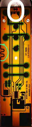

But I figured out the real problem. The remote was actually a rf remote not an IR based.
The led attached to the PCB is not connected to the circuit. I think they attached the led to make a confusion. The circuit also has a 13.560mhz crystal which is not needed for IR communication .
