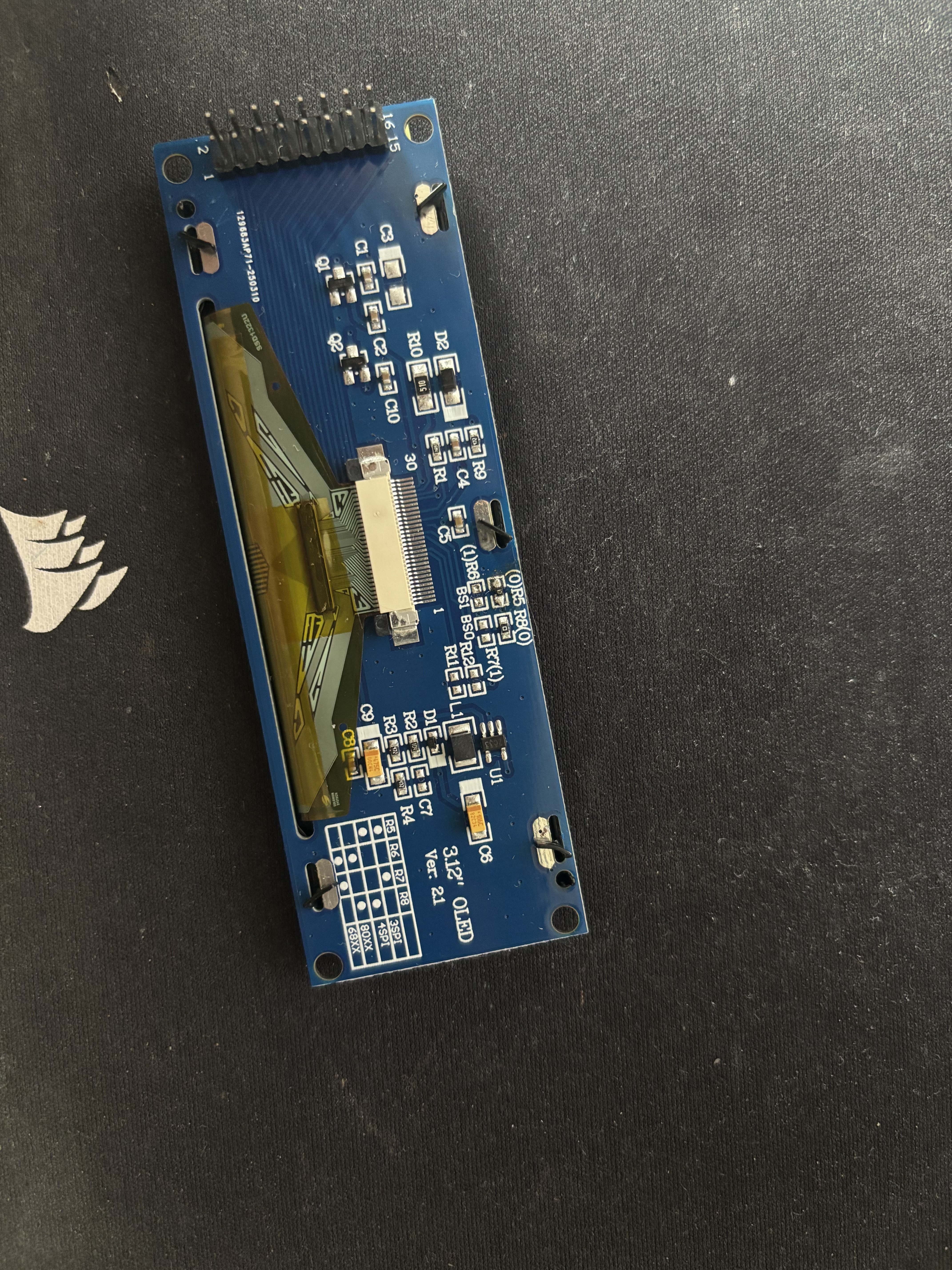

First prove you have the screen that the software is wanting to work with. You have specified a very long string
U8G2_SSD1322_NHD_256X64_F_4W_SW_SPI
Now show us the markings on the physical screen that match that.

Sorry, I see nothing remotely like 1322 on there, Why do you think that is a SSD1322?
The model I'm sure of is the SSD1322 because that's what I bought.

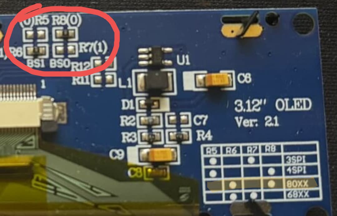

Your display appears to be configured for 80XX parallel interface, not 4W SPI.
Look at the resistors in the area I circled in red. There are resistors in locations R8 and R6:
Looking at the table at the bottom-right of the image, you can see that this configuration corresponds to 80XX Parallel interface.
If you want 4W SPI interface, you will need to move the resistor from R6 to R5.

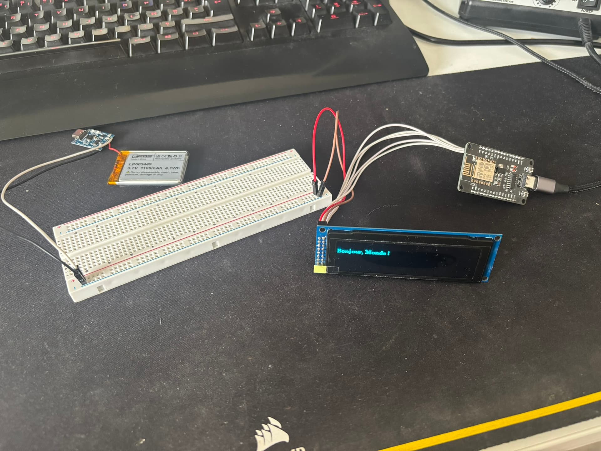

Not without difficulty I just moved the resistance. A painstaking job like I've never done before.
I checked with the multimeter and there's continuity between the 2 edges, so we should be good.
I'm going to reassemble my wiring and I'll let you know if I see any change.
After hours and hours and hours
it finally works
Thank you so much for all your help, I've learned a lot.

If you had lost or damaged that resistor, you could simply put a large blob of solder across the pads. The 'resistors' are 0 ohms!
If you had not attempted to move the resistor, you could have complained to the seller, because it was described as SPI, but the board that was sent to you was not configured that way.
