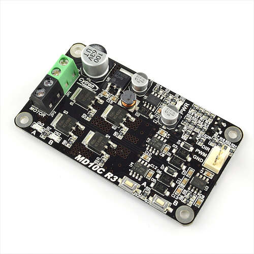

So basically I'm looking for this but with a 200+V rating and 2-3amps:
I need an H-bridge, motor driver or whatever equivalent that can handle 200V or more source voltage and also >2 amps, preferably 2.5 or 3A. Does anybody already know of such an IC or board? The more integrated, the better, so I don't have to run into a dozen problems just getting it to work. I've checked sites like Pololu already and they don't have anything in the 200V regime that I could find. Thanks.

I could build one, but I already tried that for a 24V version and it literally blew up in my face. I don't doubt that I can grasp the concept and follow a schematic but experience tells me that I achieve shoddy results when I try to re-invent the wheel. In order to prevent a red herring from misdirecting me to some problem I created myself, I'd rather have a solid, tested product to work with so that if a problem does arise there are fewer failure modes to check.
I guess this means 200V h-bridges don't commercially exist?
Ever searched for "dc motor drive" or "dc motor controller"? Lots of industrial units are made.
Here's a 200V 6A motor driver on ebay for $220.
