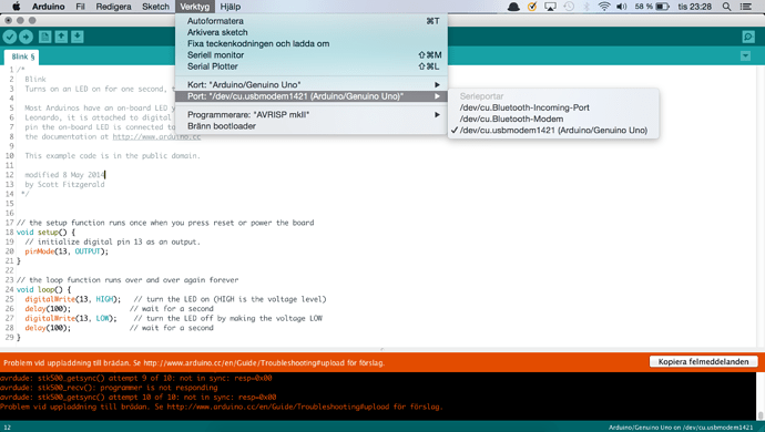

I have just gotten my genuino uno and im trying to upload a sketch to the device. I get some error messages and i dont really know why.
I have tryed looking for awsers but dont really find any thing. It says in the set up that the serial port should be something like /dev/tty.usbmodem but i can only find (as you can see on the picture) /dev/cu.usbmodem1421.
Could this be the problem and how do i fix that?
I think that's the right port.
Does the loopback test work? Try that (see instructions in sticky thread at top of installation and troubleshooting section).
You will find both cu.usbmodem1421 and tty.usbmodem1421 in the /dev directory when your Genuino is plugged in. As far as I can tell they behave identically. The IDE used to show both under Tools->Port but in recent version has chosen to show only the 'cu.' version.
