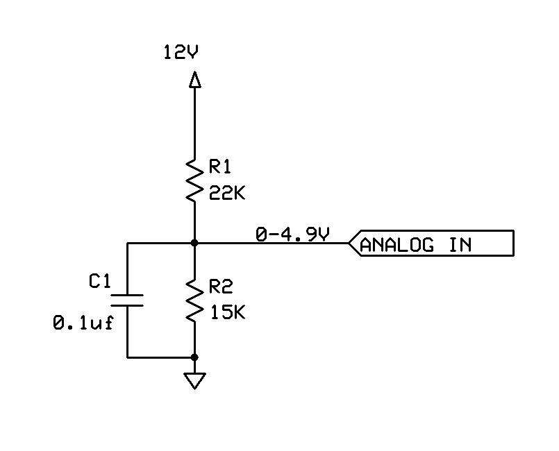

Why not use a voltage divider to drop the 12V from the sensor to 5V for the Arduino?

I think groundfungus and Wawa have given you sound advise, I would us a voltage divider.

The resistive divider is a simple, safe and cheap way to reduce analog voltages for sensing
or measurement.
In the resistor divider circuit in posting #1 the capacitor C1 is probably not needed (unless there
is a lot of electrical noise in the environment. Two resistors is enough.

I have tried a resistive divider as groundfungus suggested but I wasn't able to get the feedback either.
