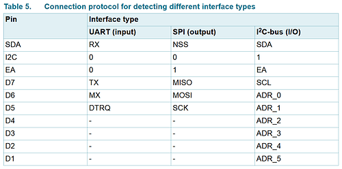

We know that I2C and EA pins of RC522 chip should be connected to 0 and 1 respectively to enable SPI interface mode for MFRC522 module as in datasheet is written (Table 5):
I've checked with multi-meter and I2C is shorted to GND and EA is shorted to 3.3V so SPI mode should be ON, isn't it?

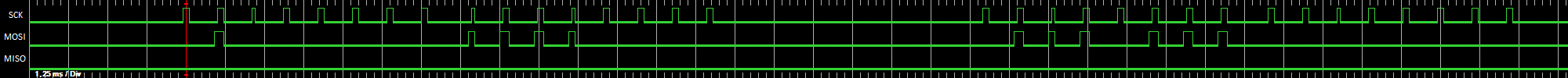

Logic ( SS( SDA), SCK and MOSI pins at the start of MCU ):

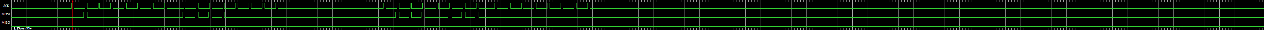

Full Logic ( SCK, MOSI and MISO pins at the start of MCU ):

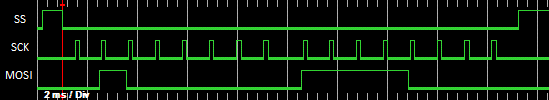

or (with immediate MOSI zero, to easier view)
As you could see, there's no answer from module:
Yes, PIC18F452 has special pins for SPI protocol (PORTC), but, unfortunately, I can't use these in this project.
All in all, no return from MFRC522_V register ( At the end an LCD is populated by " Version: 0x0" ).

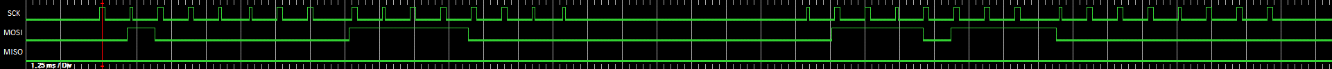

And the result in analyzer looks like:
and with "immediate zero":
As you could see, ... unfortunately, there's no result on MISO pin.
