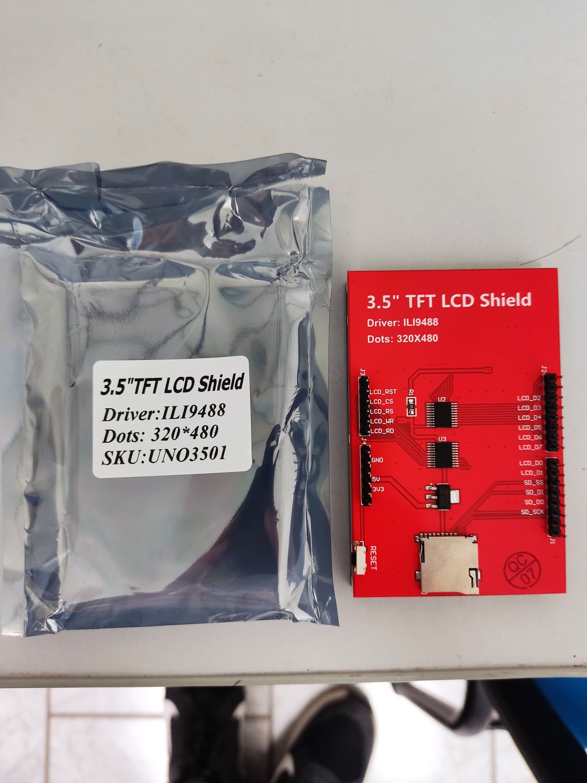

I was using an Arduino Mega2560 in a project which included, among some other sensors and actuators, a 3.5" 16bit 320x480 LCD TFT shield with a ILI9486 driver. That screen, however, got damaged, and a colleague gave me a 3.5" 8bit ILI9488 320x480 shield which he had laying around.
The new one is a UNO shield, which I planned to connect to my Mega using the USE_MEGA_8BIT_SHIELD pinout from MCUFRIEND_kbv. Since I wasn't the one who bought it, I don't know the exact model, but here is a picture:
I have been trying to get this screen to work for the whole week, but aside from the backlight, I get no response from any of the examples I tried (the ones from the MCUFRIEND_kbv library and these ones, which were used in this PDF I found from a similar shield), even when using it as intended on an UNO.
Has anyone worked with a similar shield before? I first thought it might be broken, but had the same problem with an identical one which my colleague also had.

  1. Plug the Shield from photo in #1 into the Uno.
  2. Install MCUFRIEND_kbv via the IDE Library Manager.
  3. Run all of the library examples.
  4. Plug the Shield into the MEGA2560.
  5. Run examples.
David.

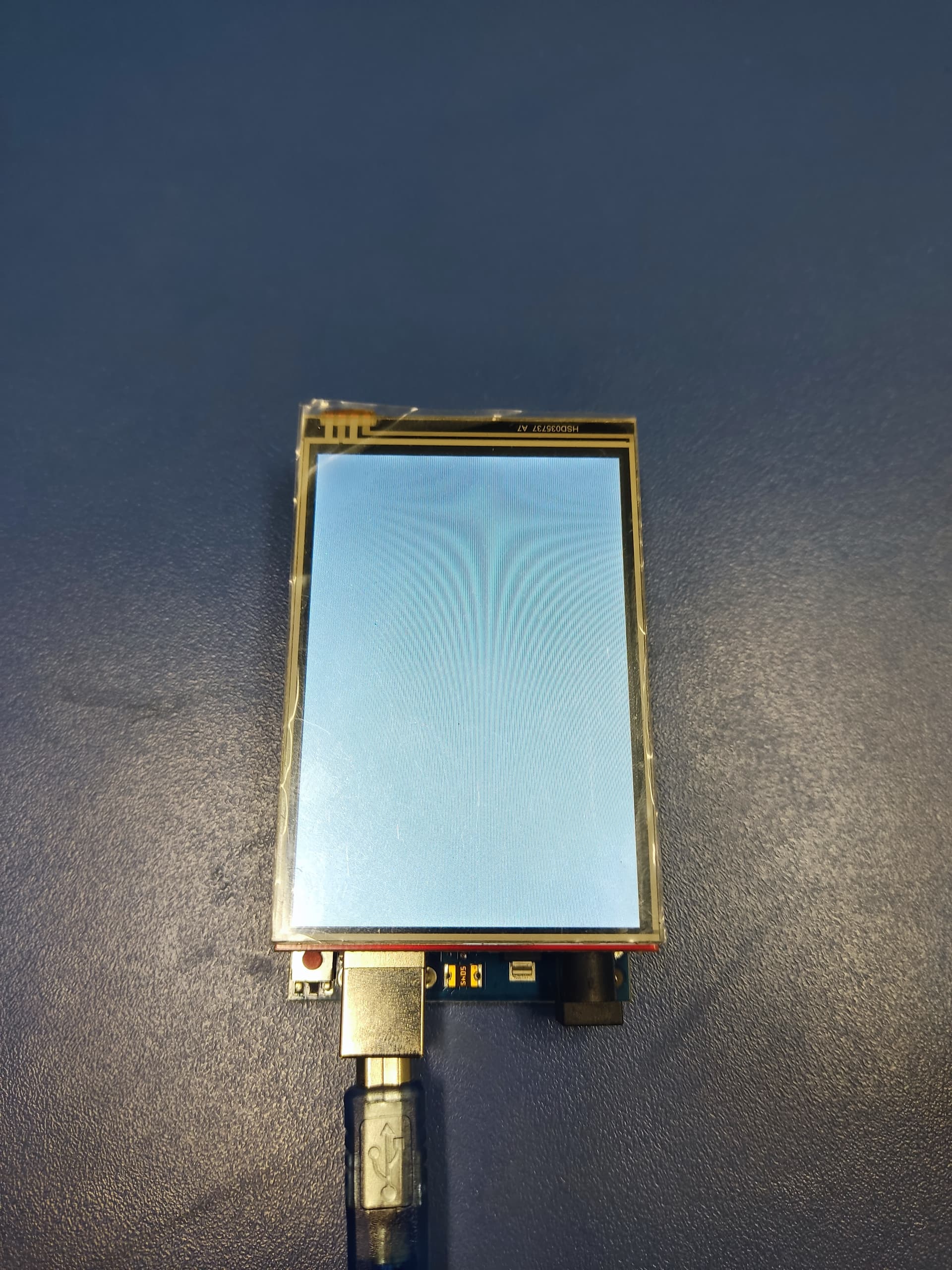

Ok, so I've:
  1. Deleted all display-related libraries
  2. Pluged the shield (same from photos #1 and #2 ) into the Uno
  3. Installed MCUFRIEND_kbv via the IDE Library Manager (version 3.0.0)
  4. Installed Adafruit GFX Library and Adafruit BusIO via the IDE Library Manager (version 1.11.3)
  5. Loaded graphictest_kbv exactly as it is in the library.
  6. Still, the result is the same as photo #2. Only backlight works :confused:

You have an ILI9488 controller.
It should work. It has read the ID correctly.
But reg(0xE0) is wrong for an ILI9488
What does the Serial Terminal say ?
David.
In graphictest_kbv, the serial terminal say:
Serial took 0ms to start
ID = 0x9488
And that's it...

He gave me two of these shields, both still on individual sealed packages (same SKU and appearence). All the tests I've run until now, I ran on both screens. According to him, they were bought some time ago for a different project which never saw the light of day, so he didn't even open the packages. Could this be a problem with the whole batch?
Ah-ha. If they were still in the original sealed bags they are probably ok.
But they might require some more "manufacturer registers" to be initialised.
What is the SKU number on the sealed package ? SKU:UNO3501
Googling UNO3501 shows that other readers have the same Shield. e.g.
https://forum.arduino.cc/t/ili9488-uno-shield/974378
I have never seen this particular pcb. But from the linked Message Thread it appears to have corrected all the normal Mcufriend electrical errors.
