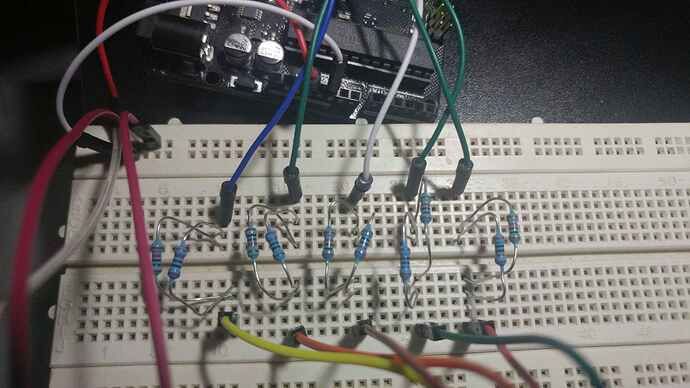

hi again .....
ok i nearly give-up on making it work , i followed like 3 tutorials and all i see is white screen only.
even i tried the potential divider and yet no difference at all.

Try with CD4050BE
It looks as if your series resistors are 5k (10k + 10k in parallel)
I can't see what resistance you have on the LED line.
It is not very easy to read the colour code bands from a photo. It would be sensible to attach schematic. Or at least say what values you are using.
I would expect 2k2 series resistors to work in the logic lines. And 47R for the LED.
The most important point is: Use RST pin in class constructor.
But the neatest solution is to make an Adapter with a Protoshield. Like in TFTLCDCyg's photos.
You can buy 6-channel and 8-channel Level Shifter chips. e.g. breadboard friendly board
Or use CD4050BE as in #10.
