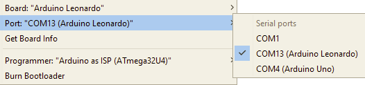

I'm interested in the upload to the Leonardo, not the Uno. Did you select the Leonardo as the board? Is COM5 the Leonardo or the Uno.
In the IDE, you should see something like below if you have both boards connected.
If you enable verbose output during upload, you should see the following few lines when the upload starts

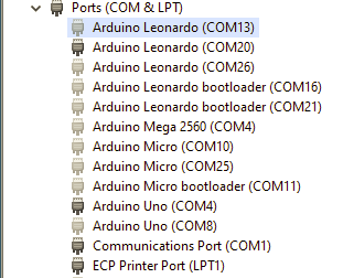

What does Windows device manager say? Does it show the Leonardo? Should look like this
The Windows device manager shows:
Arduino Leonardo (COM4)
Arduino Leonardo(COM5)
Arduino Leonardo Bootloader (COM3)
Arduino UNO (COM5)
Arduino UNO (COM5)

Tools shows:
Board "Arduino Leonardo"
Port "COM5 Arduino Leonardo"

That means that Windows might have assigned a new port; check the IDE (and device manager if needed). Change the port and try to open serial monitor again.

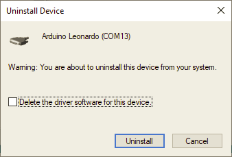

I have never done it but maybe it's time to clean the COM stack. In device manager
  1. menu View -> Show hidden devices.
  2. For each greyed out Arduino that you see, right click and select Uninstall device.image
  3. In the popup, click Uninstall; do not tell it to delete the driver
As said, I have never done this so you do this a little bit at own risk. But I think that the approach is safe.

I have tried uninstalling all the COM ports but, that didn't seem to help solve the problem. I just think my Windows 8.1 just doesn't like my Arduino Leonardo.
