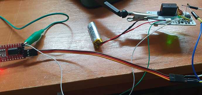

Hi! I have a problem, I have an ATtiny85 with the bootloader burned trough isp and I want to reprogram it after it was soldered so the easiest way I thought it to program it using an USB to TTL adapter, connected the TX pin of the adapter to the PB1 pin of the ATTiny, RX to PB0, connected grounds together, and DTR in series with a 0.1uf capacitor then connected to the Reset pin(PB5). The ATtiny is powered by an onboard battery. It keeps saying "Failed uploading: uploading error: exit status 1".

But when you tested it before soldering, you were able to reprogram it?
trough ISP yes
No, I meant you were able to do what you are attempting now, to program with USB-Serial.
The main reason that I want now to program it with USB Serial is to have the Serial Monitor available to troubleshoot the code because it seems there is a problem. I didn't try before to program it with USB Serial.

I didn't load the Digispark Boot Loader, I selected ATtiny45/85(Optiboot) and burned the loader from the tools section

You don't have to upload using USB. You can upload using a programmer and ICSP and debug using the serial output.
Do you have the correct clock rate selected (ie matching what you used for “burn bootloader”)?
I don't understand... I cannot set any baud rate...
is serial communication available in this state?
Do you know that UART Port is not supported by ATtiny85? However, you can emulate a TX-pin using codes in order to present the debugging messages on the OutputBox of the Serial Monitor.
