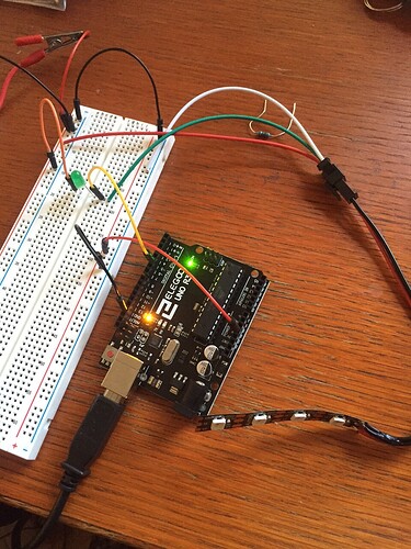

Can't see to get ws2812 LED strip working
I've tested the voltage on the strip with a multimeter and the green led does blink twice a second, but the strip leds do nothing. Any ideas?
Picture attached... my code:

Why is there a green LED (without current limiting resistor) from the data line to ground.
That limits data signals to Vf of the LED (~2.2volt).
The strip needs a 5volt data signal to work.
Remove the LED.
Four WS2812 LEDs can be powered from Arduino's 5volt pin
They only draw 4*60mA (max), and that's ok on USB supply.
Leo..
P.S.
A common LED without current limiting resistor draws more than 40mA from a pin.
That is over the maximum limit of the pin, and will damage it.

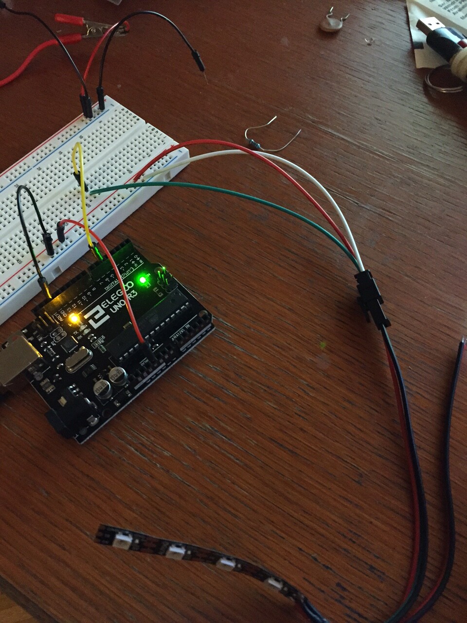

Thank you for the reply! I've simplified the circuit (see pic), but still a no go. I just had that led in there to confirm there was something coming out of pin 5. I'm not using an external power supply now either.
Did you cut that short LED strip off the end or off the beginning?
From careful looking at your first photograph it looks like you cut it off the end and you are trying to feed a signal into the output of the last LED. That is not going to work.
You will have to inject the signal from your fake Arduino into the middle connection of the cut off end of the strip.
That's it! Thank you!!! So, you have to send signal upstream from those arrows I presume
