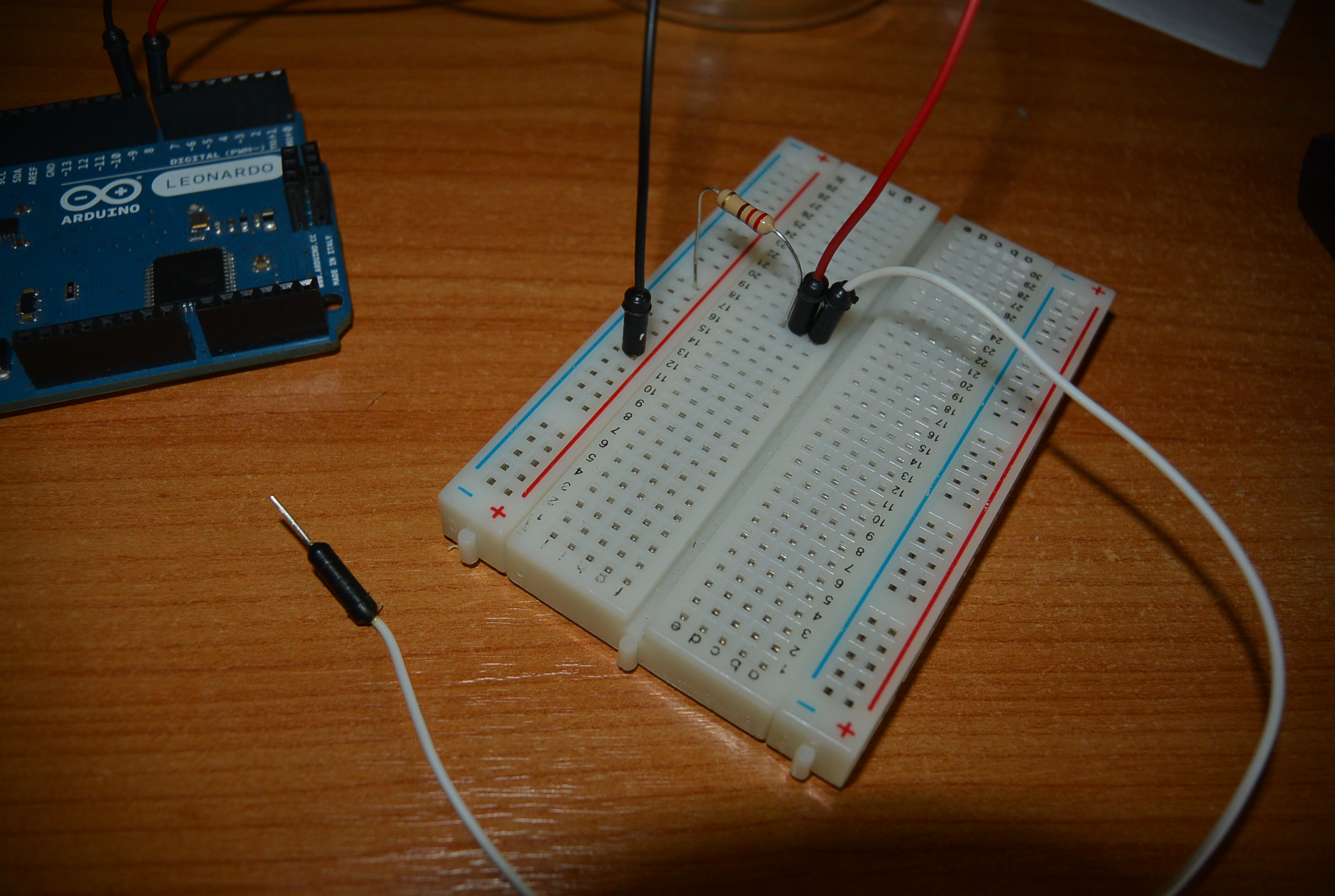

I have an Arduino Leonardo and I'd like to use the CapacitiveSensor library.
I have everything set up correctly but the sensor reading returns 0 all the time, it doesn't react to touching the sensor cable.
Can tou tell me what the issue could possibly be? Any help would be appreciated.
My configuration: BLACK - sendPin (8 ), RED - receivePin (7), WHITE - sensorPin (I touch this one).
I use a 1 MegaOhm resistor.
CapacitiveSensor   cs_8_7 = CapacitiveSensor(8,7);
long start = millis();
    long total1 =  cs_8_7.capacitiveSensor(15);
    Serial.print(millis() - start);        // check on performance in milliseconds
    Serial.print("\t");                    // tab character for debug windown spacing
    Serial.println(total1);                  // print sensor output 1
    delay(10);                             // arbitrary delay to limit data to serial port

Hi, can you post the complete sketch, so we can see if the setup and includes are okay.
Have yu read here?
http://playground.arduino.cc/Main/CapacitiveSensor?from=Main.CapSense
You have a 220 Ohm resistor between send and receive pins, they quote at least 100K Ohms.
Tom........ :slight_smile:
