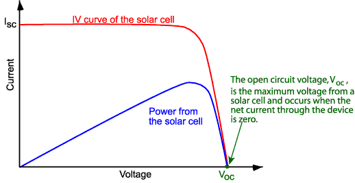

Yes, that is if you charge the capacitor with fixed voltage. To make things clear for you, what I'd like to achieve: the problem is solar panels dont give you steady voltage, so if it's cloudy say the cap will charge at 4.4V, when it's charged then the second supercap will start to charge, so both supercaps will be charged. But then it starts to be sunny and the voltage rises to 5.5V but only the first supercap will start charging, when it's charged second will start charging.

Unless you're using some sort of maximum power point tracking converter between the solar panel and the capacitor(s), the solar panel behaves more like a constant current source (at constant light intensity) than it does a constant voltage source. The voltage level across the capacitor is entirely a function of its state of charge and it will pull the solar panel down to that voltage (ignoring voltage drops across whatever switch network connects the two). That is, if one simply puts a discharged capacitor across a solar cell under constant light, the voltage will start at zero and rise approximately linearly with time until it approaches the open circuit voltage of the solar panel, or more accurately, the current knee in the diagram below.
I'm not clear on the size and complexity of this proposed installation. For a relatively large scale installation optimized for efficiency then perhaps it's more complicated than I've suggested. In that case a converter that tries to keep the voltage across the solar panel at the peak of the power curve while charging the storage device might make sense, but this isn't trivial to implement.
It's very small, area of solar panel will be 330 cm2, something similar to jremington's suggested tutorial.
