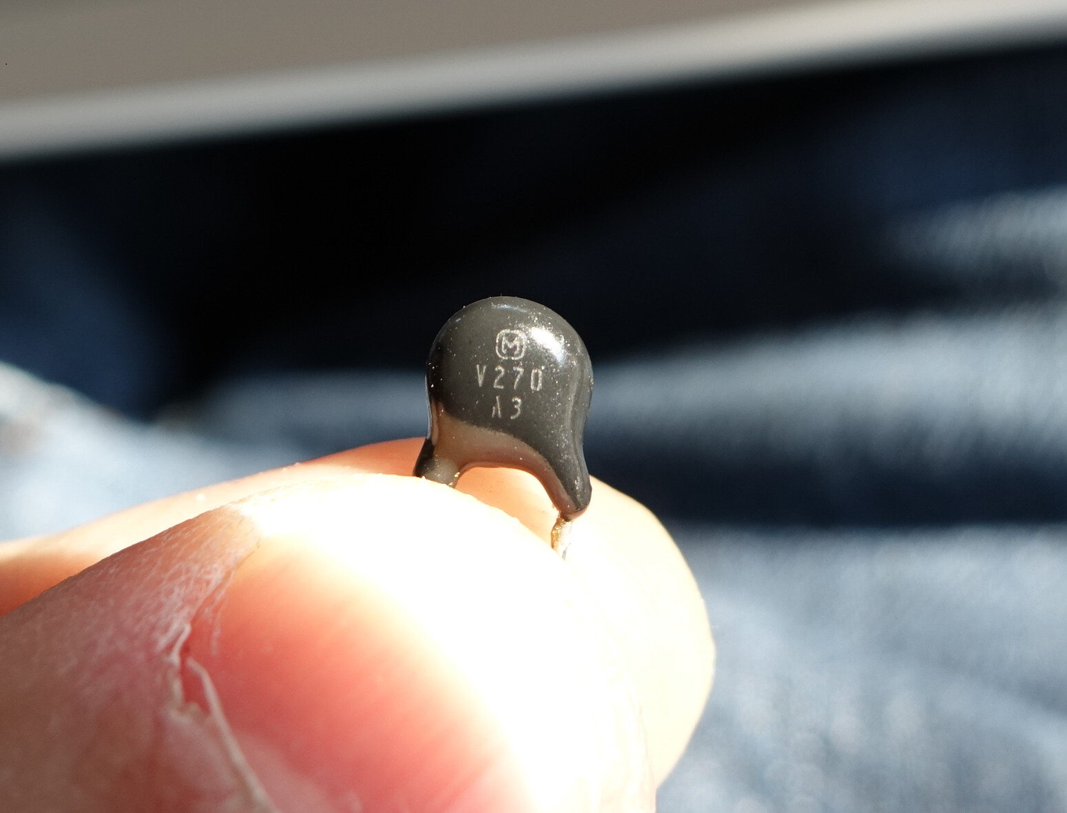

Hello,
I was wondering if anyone could identify what looks like a film capacitor, from a small electric motor, with markings V270 A3 (I'm not sure about the "A" bit).
I've attached a photo of it.
Cheers.

AC motor or DC motor?
Paul

Paul_KD7HB:
AC motor or DC motor?Paul
DC 14v

Perhaps this is your part........ V270
JohnRob:
Thanks, that could very well be it.
Would its failure prevent the motor from running, and could the motor be tested without it?
I guess it was used instead of a flyback diode, to suppress transients when the motor is switched off. Advantage over a diode is that it would work in both directions.
It seems to me you can test the motor safely by just connecting it to an appropriate power supply directly. Make sure your power supply can handle the current the motor needs. A regular brushed DC motor doesn't need any extra parts to work.

Certainly doesn't look like a film capacitor as those don't come in plate varieties.
JohnRob:
A MOV - "V270" - 27 V, with a grey encapsulation. Yep, that would definitely be it. The "A3" is the joule rating (category).

While not a perfect match, also not that far off (this are film capacitors):
A MOV fails "OPEN", so that would have no bearing on your motor operation. The motor brushes are probably bad.
Paul
I wouldn't assume it would fail shorted.
Is the device still in the circuit? If not can you measure its resistance?
If the V270 measures high resistance it's probably OK an would likely not result in the motor not starting.
Without more information, I would expect this device is protecting some switching element. If operated with out this device the switching element could eventually be damaged (causing it not to start).
Thanks to all for your replies.
I tested the motor without the V270 and it was unresponsive, so I opened it and the brushes are in pieces, so the motor itself will have to be replaced.
I'll keep the varistor, if that's what it is, for the new one.
Brushes are consummables, you'll be able to find some sort of replacement given the dimensions probably.
But the question then is - why are the brushes in pieces, unless they are already completely worn down?
Could be other problems.
Well nothing an armature check wouldn't uncover.
Commutator?
