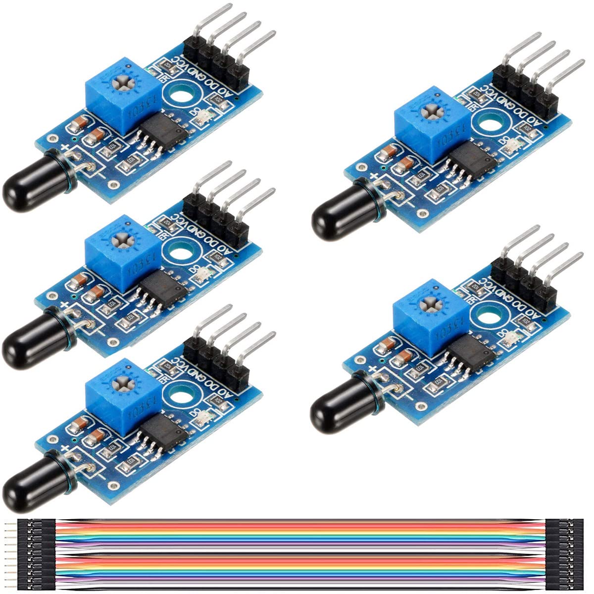

how can i distance control from the flame
sp the car wont keep running into the flame?
Please stop creating topics then deleting them
Post a link to the specifications of your flame sensors. Maybe they have both an analog and a digital output. Using the analog output, connected to an Arduino analog input, your code may be able to know the brightness of the flame, which will increase as the car gets closer to the source of the flame.
sorry i dont know how to erase the thread completely
this one
in my code i am trying a left turning of the car ,but i dont get a responses on the left sensor.
i tested the sensor on its own and it works.

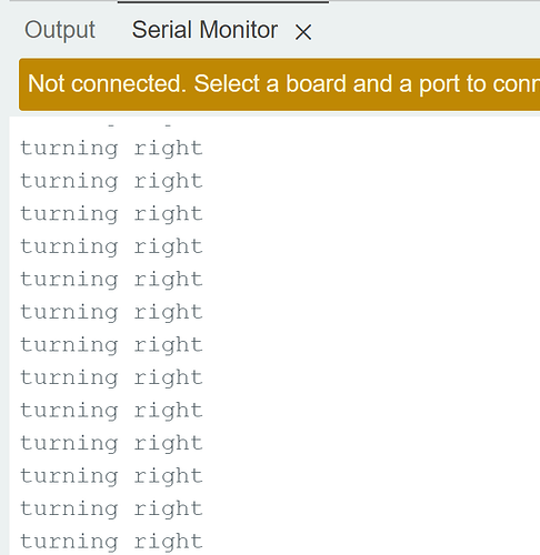

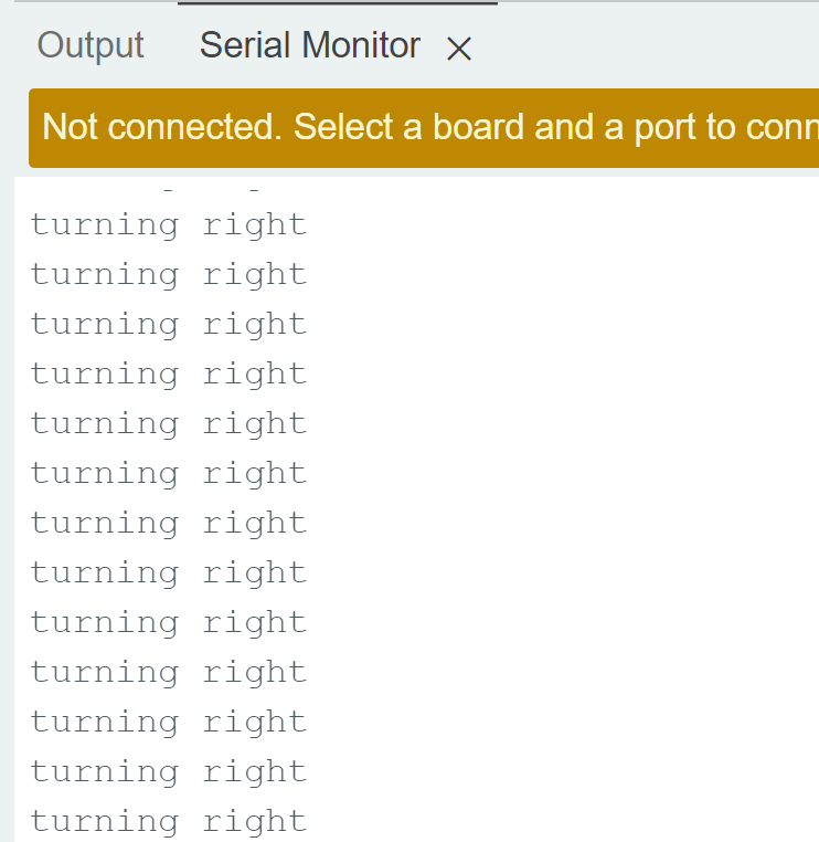

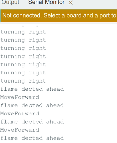

What model Arduino are you using?
disregard the code.
the center flame sensor is pin 15 and the left is 17 (the wokwi doesnt have flame sensor)
so i change the code since last time, realised the problem with the third condition.
that the new one

and getting
there is no flame presence but it seems stuck on the while loop
while(FlameCheckForawrd != LOW)
         FlameCheckForawrd = digitalRead(FlamePinForawrd);
         Serial.println("turning right");
         CAR_turnRightWifi();
         delay(200);
It is stuck in the loop because there is no flame presence!
If there is no flame presence, how did it get into the if statement that is before the loop? Are the sensors adjusted differently, so that the left sensor detected the flame but the forward sensor does not?

when i put a flame in front the front sensor i get
